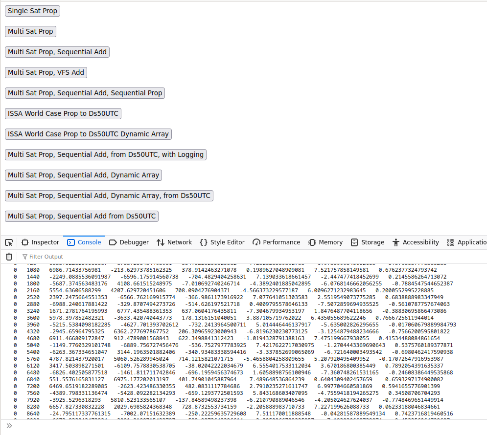

for people here that want try this SGP4-XP, can try on web browser. what you need is web browser and python.
download v9.1.1.0_C_Sgp4Prop_Wasm.zip from here
extract it
in linux, open terminal:
cd v9.1.1.0_C_Sgp4Prop_Wasm
cd example/
python -m http.server --directory ..

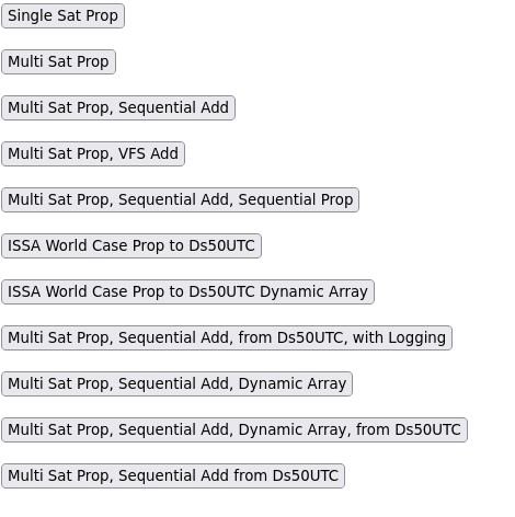

open your favourite web browser.
open Web Developer Tools > Console (CTRL + SHIFT + I)
http://localhost:8000/example/Sgp4Prop.html
it will show like below:

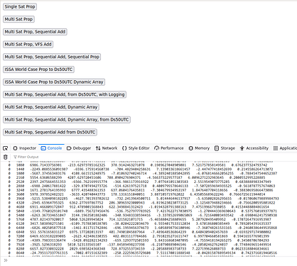

click [Single Sat Prop] button , upload your single TLE sat .txt file. maybe you question, the tle ephemeris is 0, but why this tools can calculated. yeah, because this tools have backward compatibility that can automatic check is it common TLE (0) or XP TLE (4)
result:
