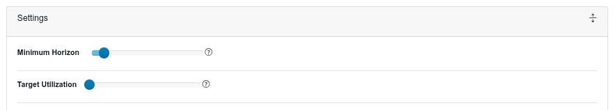

Is see you set target utilization to 100%, please set it back to 0% and lets see if that will help.
No idea how to read or explain this utilization percentage.
I made that change about two hours ago. No change in status. I’ll check in the morning US time.

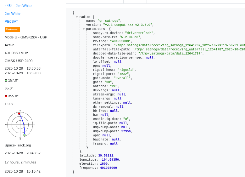

from observation metadata:
samp-rate-rx: "w.2.048e6" should be 2.048e6 or 2048e3 (same).
antenna: "rx" should be RX.
gain: null should be some reasonable (20-30?) value in the 0-42 range or what the sdr supports.
see the omni station howto. some instructions might be outdated depending on your specific setup.
Thank you. I changed RX and gain to 30. I’m in a quite environment so will start with 30.

You missed samp-rate-rx, this should be 2.048e6, no w. in front of the value.
Maybe I was unclear, SATNOGS_RX_SAMP_RATE should be 2.048e6
