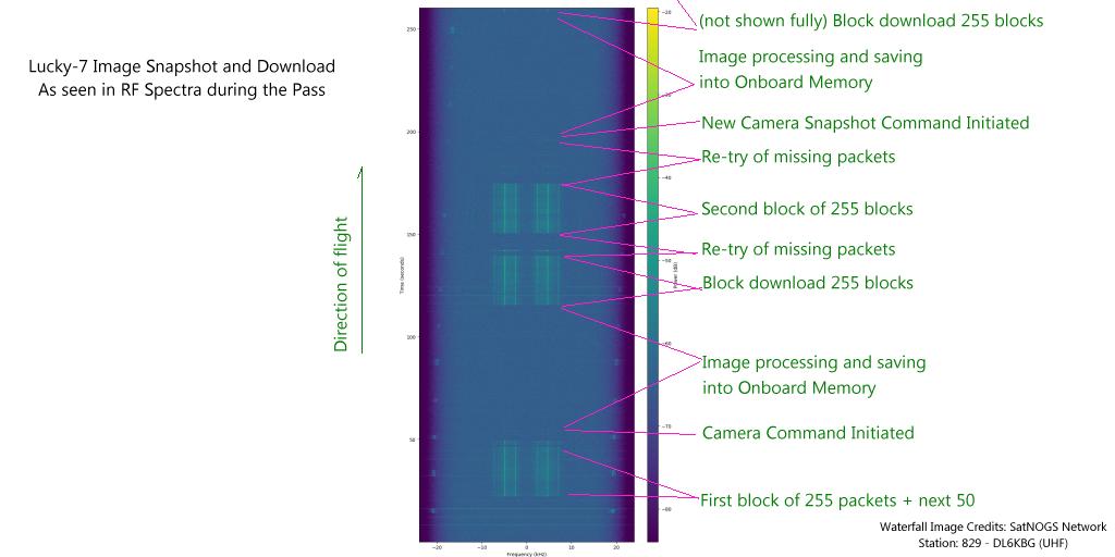

well this Observation got a mention over on Twitter from SkyFoxLabs (Lucky-7) i just want to share their explanation:
SatNOGS is fun.
73 Oliver
