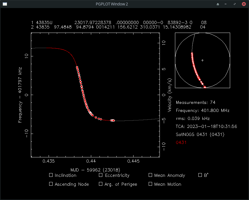

Using the TLE from space-track for object 43835 and fitting it to Observation 7046545, as we shared via our #satnogs matrix channel, yielded the following results:
1 43835U          23014.20174576  .00000000  00000-0  64271-3 0    01
2 43835  97.4849  91.1717 0013590 170.1455 275.1811 15.14212796    06
# 20230118.44-20230118.44, 74 measurements, 0.026 kHz rms
Plot by @cgbsat :
7032120
To validate this new TLE is against a different “good” Observation of EPIC CHIMERA LEO 1, I selected Observation 7032120 with the following results:
Thus, whatever the object in Observation 7046545 and 7032120 is, we can track it with this new TLE.
