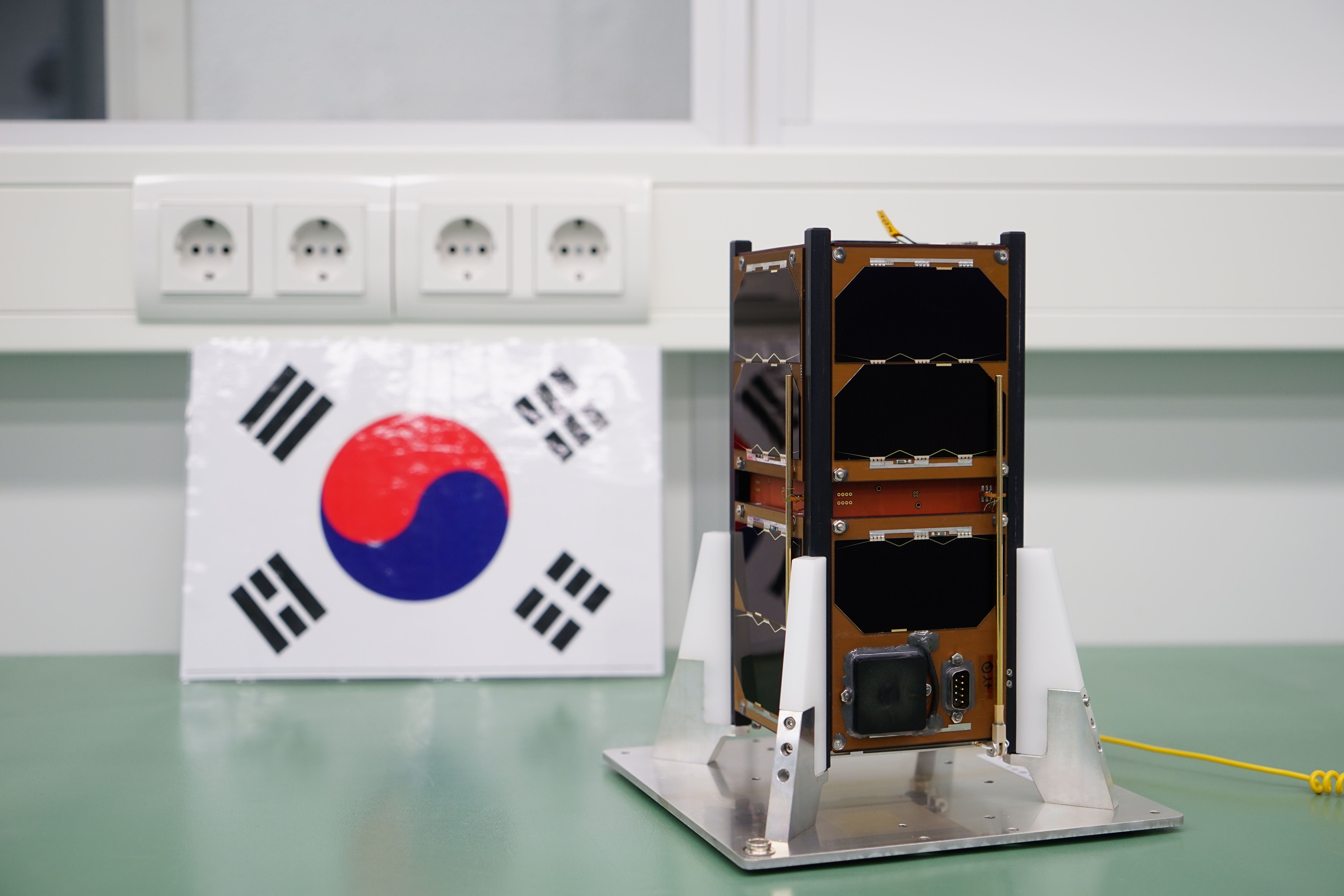

Regarding Observation 365909 …
Thank you for your all efforts.
The telemetry must start with ‘44 53 30 44 48’. It is our call sign DS0DH.
Therefore it is not SNUGLITE telemetry.
Please check the signal.
