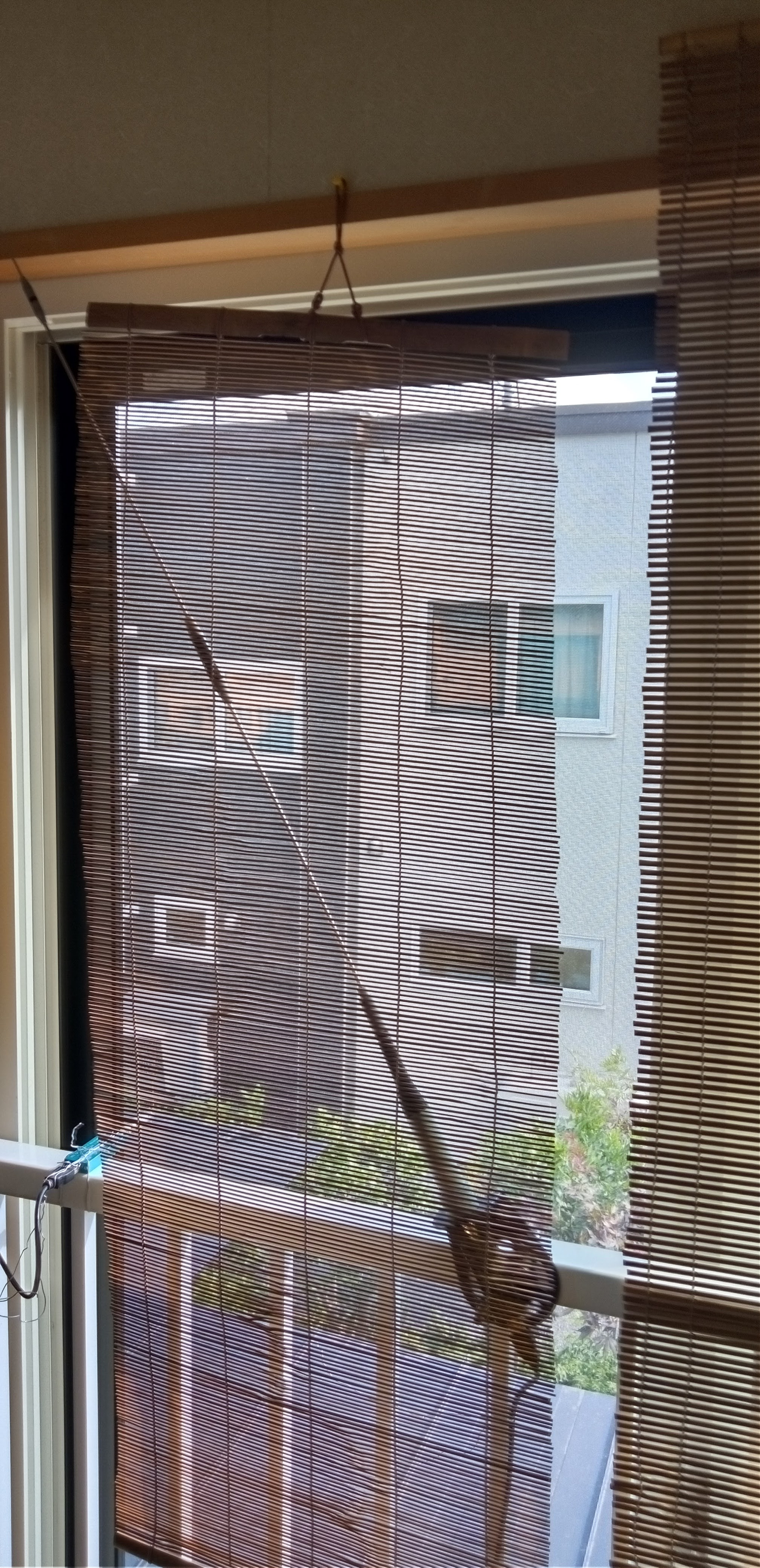

I recently ran an observation for TRITON-1 (Observation #14834170) using my station (4950 - jp7dvx), which achieved a nearly overhead pass with a maximum elevation of 89°.
The waterfall clearly captured a nice Doppler shift curve with twin traces around -5 kHz. However, the observation status ended up as “Unknown,” and it didn’t seem to decode properly.
Could anyone advise if this transmitter behavior is expected, or if there is something I should adjust in my station setup for this mode (1200bps RC-BPSK CW)?

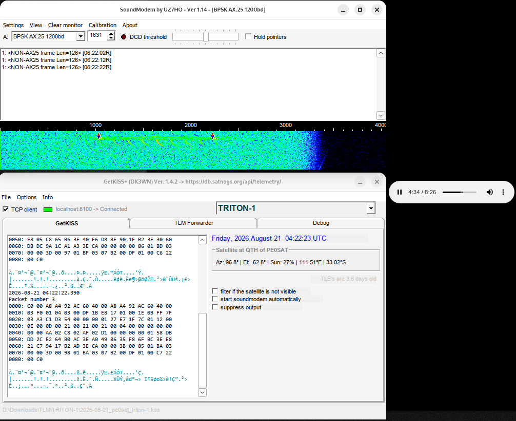

As far as I know the satellite is no longer active, here an observation with very weak CW signal
More information on Triton-1 can be found at the following locations:
Triton-1 recovery.
The sound of the BPSK telemetry This can be decoded with an BPSK AX.25 modem.
Satellite details
Decoding the audio wav file:
The doppler shift curve you see is from something else.
I know TRITON-1 only from very weak CW signals.
My last reception was on 2024-02-24.
