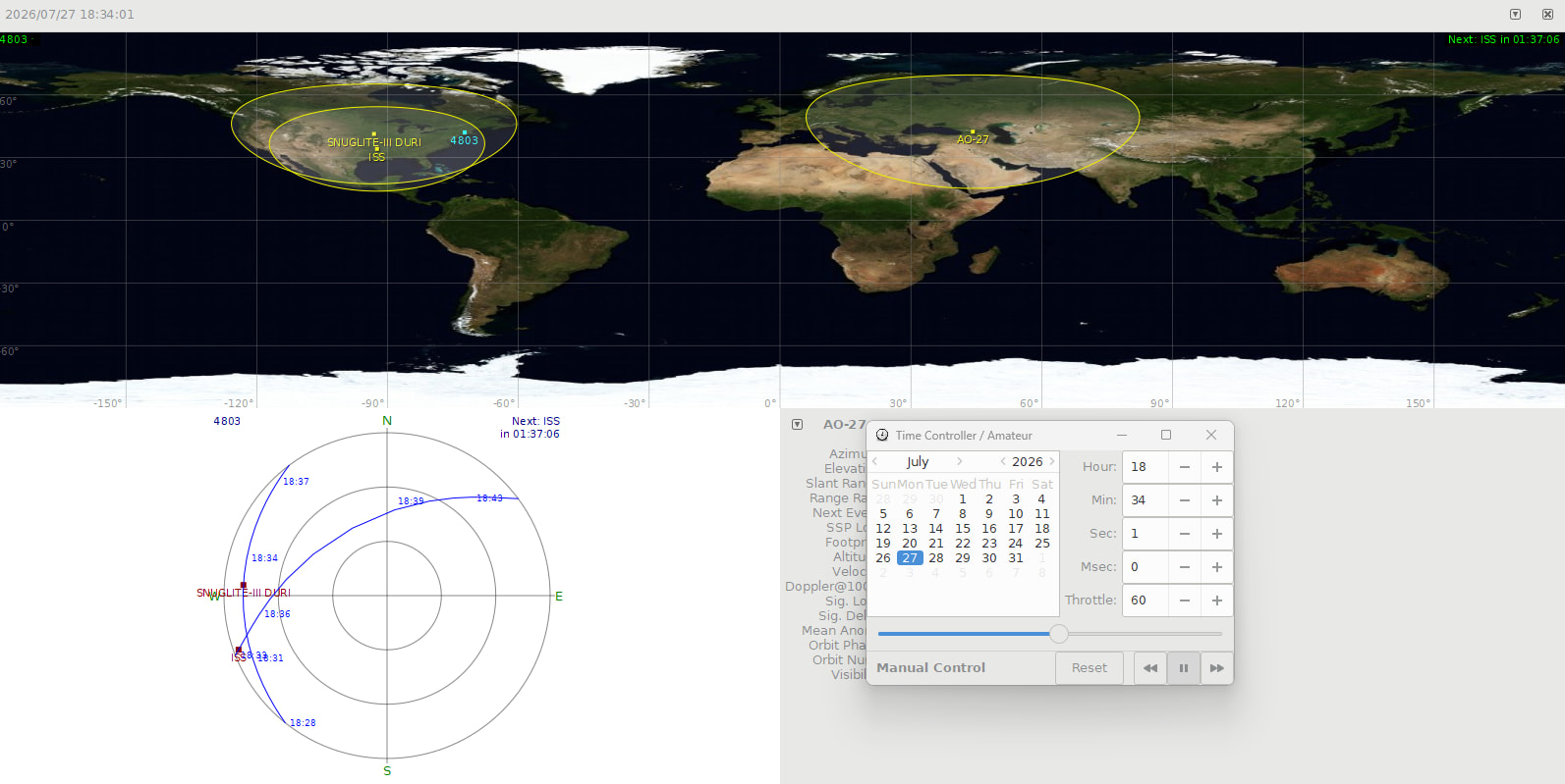

Could have been AO-27 on 436.798Mhz? SatNOGS DB - EYESAT-1
The math is much easier to explain with AO-27 instead of ARISS.
The doppler does seem to work out on explaining this.
Not a good pass for SNUGLITE III, but it was an interesting one!
73 - KC1OCA
Can confirm it was not AO-27

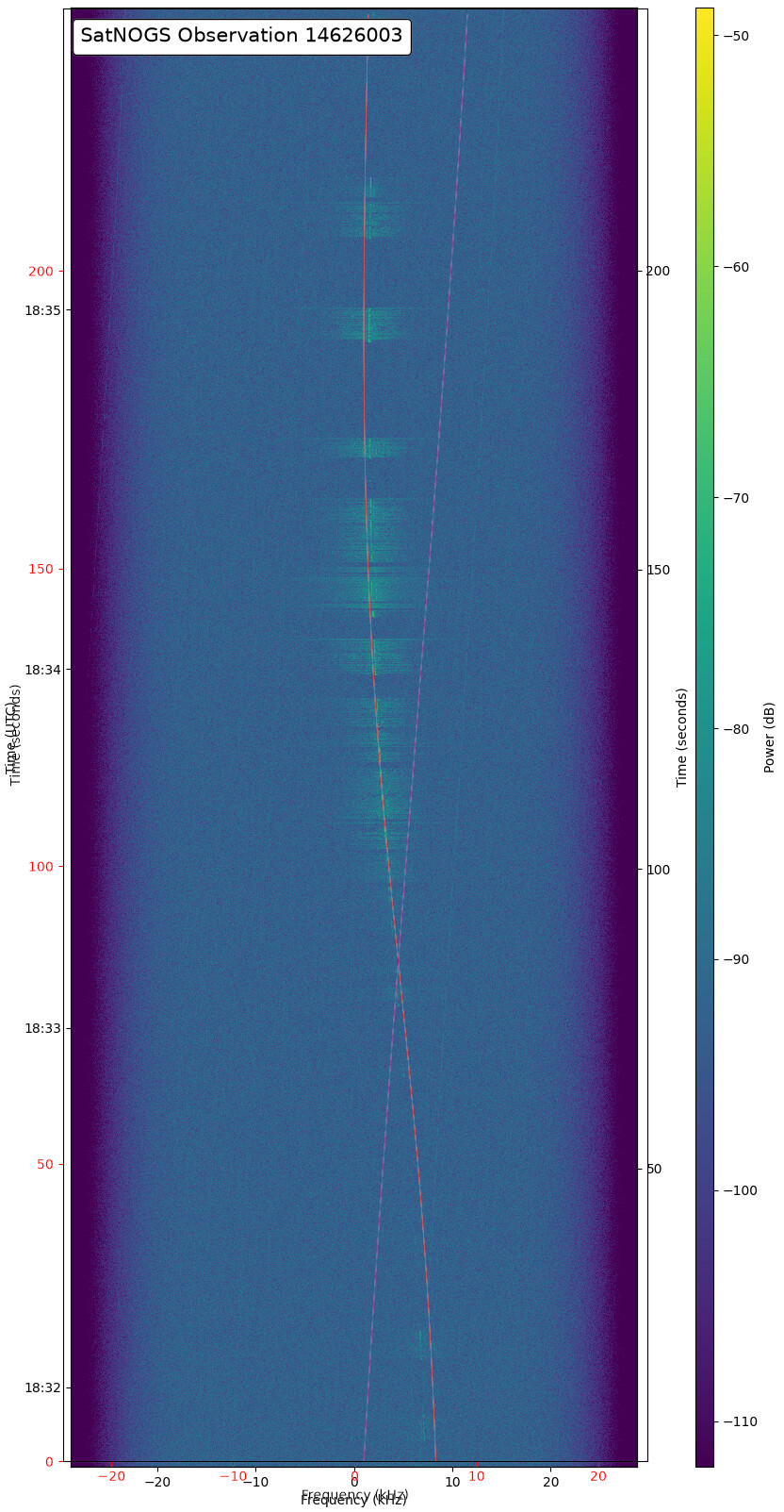

I have done some more research it could have been SAUDISAT 1C as its the only satellite (in satnogs) with a “near by” (5 Khz offset) frequency SatNOGS DB - SAUDISAT 1C Its drifted downlink is at 436.793 Mhz while the obs freq is 436.788 Mhz. (Also checked an ISS obs at the same time and its for sure not the ISS. Attached is my attempt at using ikhnos with it drawing the line at 5 Khz offset. (Used the command “python ikhnos.py 14626003 -f 5” with the old Saudisat 1C TLE from the network.
