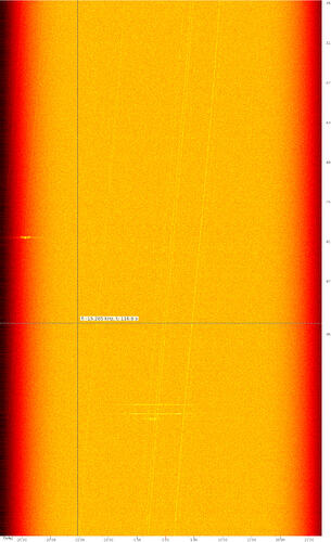

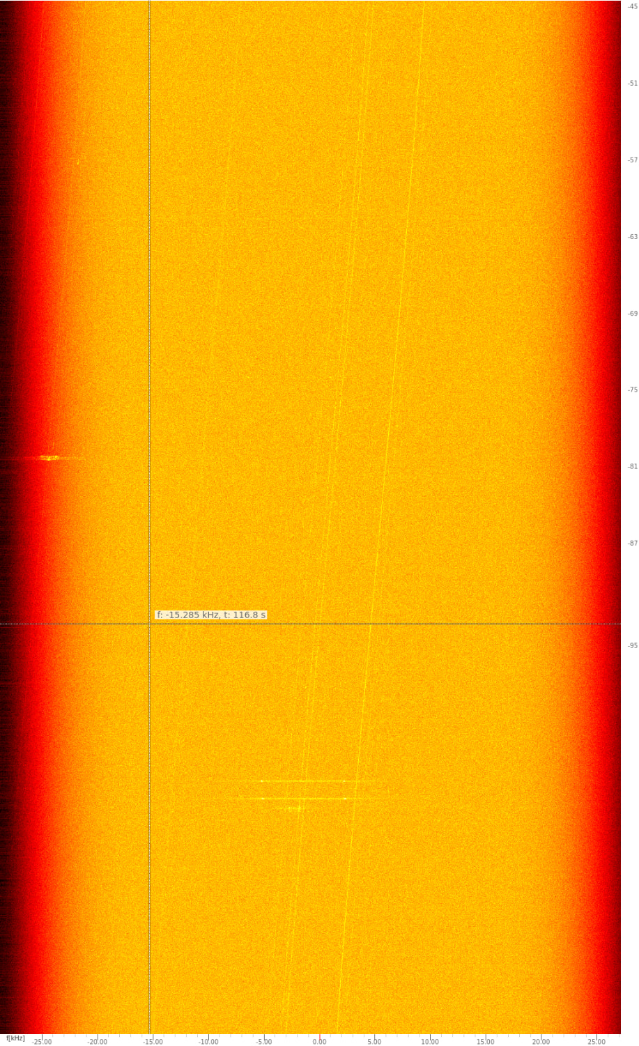

enhanced waterfall from this obs
between beacon around 120s. perfect!
DRISHTI
