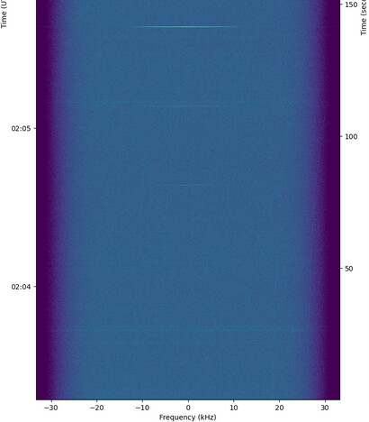

Observation 13956764: ArcticSat-1 (61762)
Regarding Observation 13956764
arcticsat-1 on 19k2:
-> Packet from 19k2 USP FSK downlink
