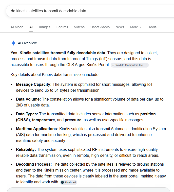

I asked in Google and the AI assistant says:
Thanks for doing that, also i didnt exactly expect images from kineis no, but because there was no data at all in my observation, not ascii or hex, it just shows “waiting for demoded data” so i assumed it was not a signal😅
