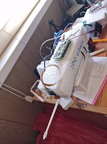

Pi (zero, 2,3,4 ) can transmit camera images with ssdv tracker software.

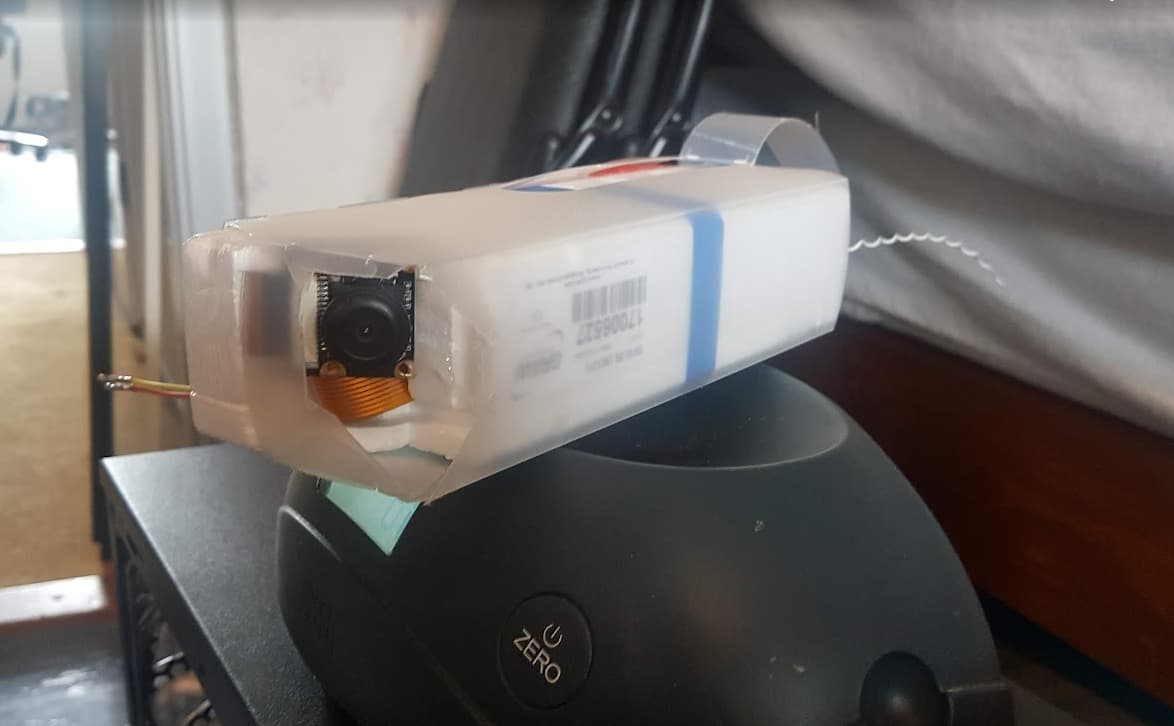

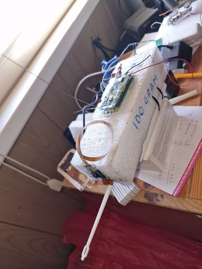

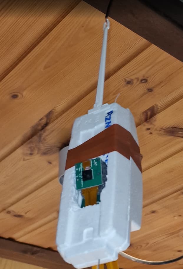

Pi zero and camera in an RS41 housing
Pi Zero and camera in an DFM09 housing
Pi zero that flew pointing up for the size of the balloon images
