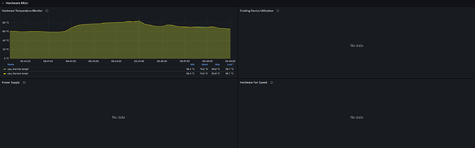

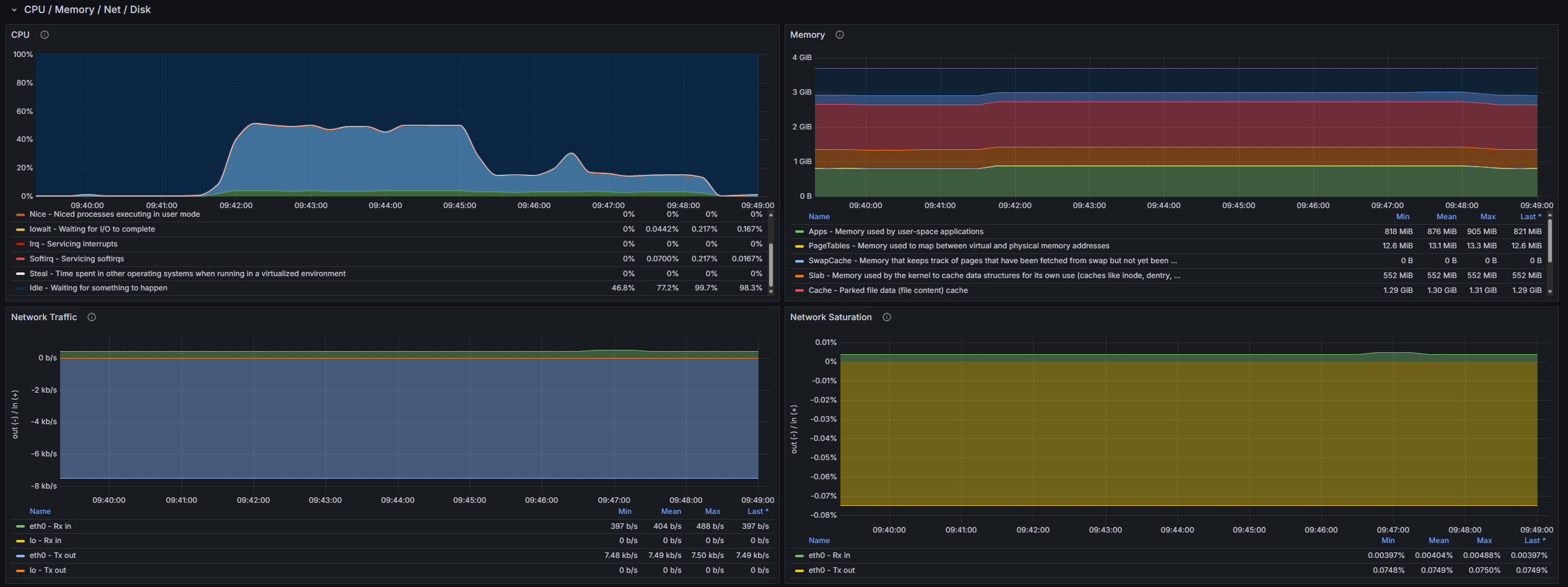

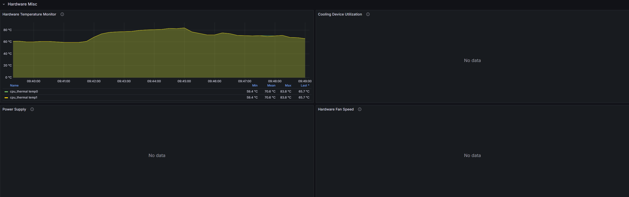

I have grafana data for the pass that we talking about.
http://localhost:3000/dashboard/snapshot/5fF0M2AjPhpm86J1FTTZfGZrUeWVoZJV
unfortunately I do not have power supply monitor but temperature seems ok
It clearly is above 80C which is pretty bad, it will start throttling at that point. Heatsink and maybe fan. I use the small metal chassis that acts as a heatsink as well, no fan needed usually.
for reference rpi thermal control.
