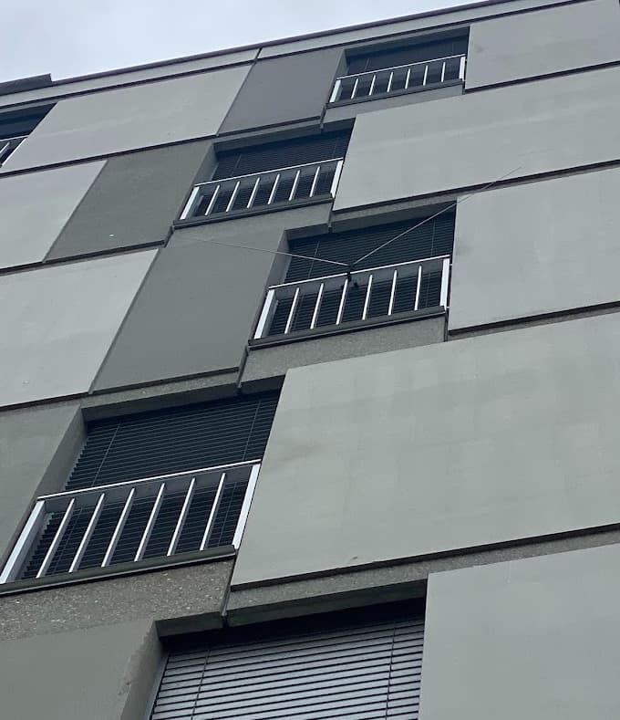

Can you share some details on your dipole antenna, to be honest I am pretty surprise by the amount of frames it is picking up.
The easiest way get some extra SNR is to add a LNA, I have pretty good results with the Nooelec wide band models, far from optimal but a start.
Sure!
This is the exact setup:
I know it’s a very cheap and rudimentary setup, but I just started and I didnt expect to get actually data…
Its not a simple V dipole… the balcony railing its a reflector.
Yes, so for my next location I’ll definitely consider to stay far from metal sources. this might already improve. noted.
well, it’s not always bad, it can provide directionality, if you want it (: althou a traditional reflector for a yagi (even 2el) is a very specific length.
it also affects impedance, which the angle of the V also does. so if the design calls for 120deg in free space, it will probably go a bit lower if it is close to a balcony rail for example.
for reception I would not worry too much about it, where the main lobes point and what signals you get is more important than perfect matching.
