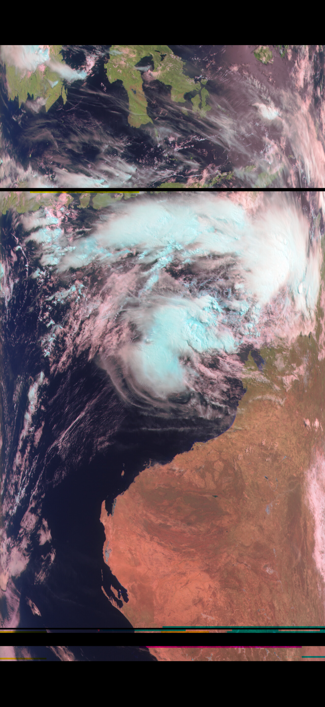

The format of the IQ dump is s16 and not f32 so you need to change that in the satdump command line.
The freq_shift option should not be used either, this is only for tine tuning the center frequency, and in this case it is already at 0, and absolutely not 137.9MHz from the IQ files DC.

Awesome, reading it as s16 did the trick. I also just realised that I need to select LRPT IQ Usage FSK, because my last observation was set to LRPT RHCP 7200 and the sample rate was too low for satdump to decode it
As for the satdump script, I’m certainly happy to put something together for posting demoded images when I get the time.
