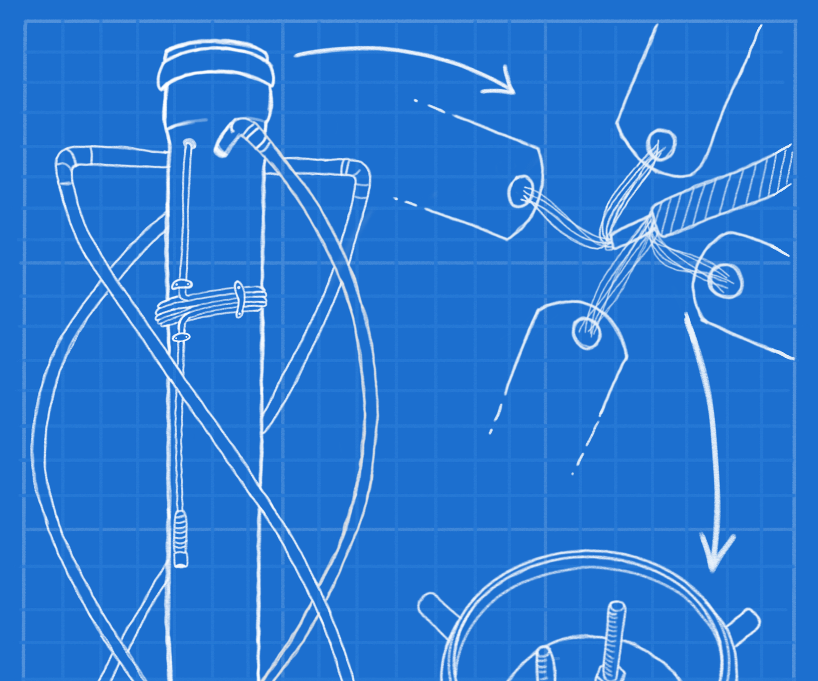

I made the QFH antenna myself last summer. I did not do a balun with the coax cable, like it is showed on this tutorial. Could it be that the noise is because I don’t have a balun ?
More generally speaking, why do we need a balun to a QFH antenna, even though the antenna strand are not the same size.

what i know, the balun is to choke the noise from cable. so it should be put after antenna as close as possible. (ussualy with wind the coax around your qfh pvc tube)
maybe you can try with this:
QFH antenna → RTL SDR LNA (put it as close as after antenna) → balun choke (the simple way: just wind the coax around pvc tube) → lenght cable to your raspi (for the best result not more than 4 metre for UHF) →FM Notch (optional) → RTL SDR → Rpi
