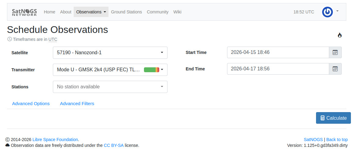

I’m afraid I’m missing something obvious. This last weekend, I JUST got my station up and running, and I spammed a bunch of observations… then I couldn’t schedule an obs for Monitor 3. I figured MAYBE because I’d already hit UMKA-1, and they seem to be cousins up there, always within a few minutes of each other.
Now, I’m trying to schedule obs for Nanozond-1 before it dusts, and again “No Station Available”, even though I KNOW it’s going to pass overhead (unlike IO-86, no offense, Bali!).
My process:
  1. Go to (https://network.satnogs.org/observations/new/)
  2. Satellite => Nanozond-1 from dropdown list.
  3. Watch as it populates the transmitter and the station.
  4. Uh… crap. Transmitter defaults to GMSK. My station usually auto-populates, but it doesn’t. If I switch to Silversat, it populates SSDV and my station. Back to Nanozond, and GMSK/No Station available. Switch from GMSK to SSTV, still nada. Freqs are UHF, and that’s what my station is set to… so…
Is there a secret button I’m missing? Need to squint my left eye, not my right eye? What am I doing wrong? Monitor3 and Nanozond are both polar, both go over my house, and I collected a bunch of Monitor3 manually. So…
Help?
chris
RS58S (Monitor-3) as well as RS49S (Nanozond-1) have no IARU coordinated transmitter.

“… no IARU coordinated transmitter.” So what?
I see other observations for Monitor3. I see in the image above that GMSK has a huge number of positive SatNOGS collections (green) vs. unknown (orange) or bad (red).
It SEEMS that the lack of IARU coordinated transmitters has no bearing on SatNOGS stations collecting it.
Unless there’s a checkbox for “Only collect IARU Coordinated Transmitters”. I don’t understand why other CAN and I CANNOT.

what i understand, for every sat that has label frequency misuse, only have limited chance to obs.
so the best way if you interest is just ask @fredy to schedule it for you.
Hi Chris,
Please also confirm the following setting for your ground station.
Daniel
No that’s not true, I’m (and the people that belong in the operations group) avoiding scheduling for these satellites if there isn’t any SSA interest. In short this is our way to pressure satellite teams to coordinate when they use the amateur radio bands.

@fredy : Thank you very much. That explains a lot and was in the same direction my thinking was headed… I just couldn’t find the answer with my searches. I had searched the Wiki for “IARU”, but I didn’t notice the article you shared. Not that my vote carries any special weight, but I agree with the positions taken.
@dl7ndr : Daniel, thank you. I’d looked at that toggle a dozen times, but “Frequency Violator” never registered (I had convinced myself it was who I was allowing to sked my station… AT ALL). You are another great source of knowledge and a wonderful contributor that I follow a lot… It’s just that your knowledge is so far beyond mine that it’s super hard to catch up sometimes. Thank you for being patient with me.
