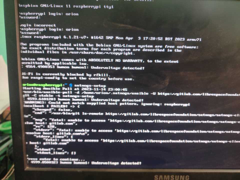

This is the error I am getting. What should I do?
What install method are you using, please share more details and try to share the log information and not an image that is very difficult to read.
Because I am unable to clearly read the image I need to assume a couple of things, but here some examples of things that stand out:
Raspbian GNU/Linux 11 that seems to be an old version.
Undervoltage detected the power adapter can’t deliver enough current.
