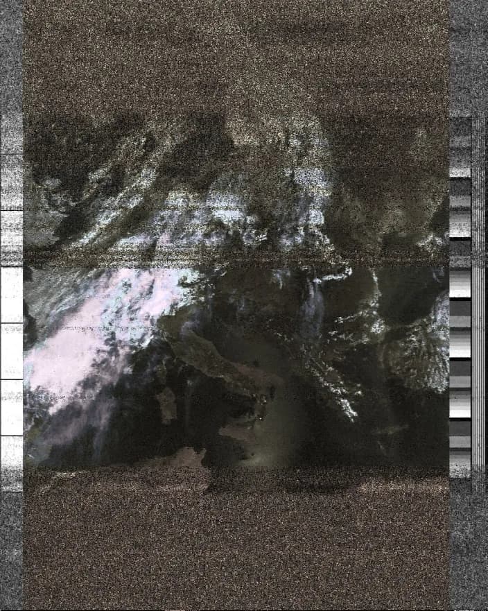

I changed the gain to 30 just to test about 3 minutes before my next pass and i actually got something.
https://network.satnogs.org/observations/11689718/
Now how could i optimize the best gain value? I read the wiki about it, but it didn’t help me much, is trial and error the best approach?
Excellent result for now ! By looking at the image you appear to be somewhere in Italy ? Might even be Greece …
