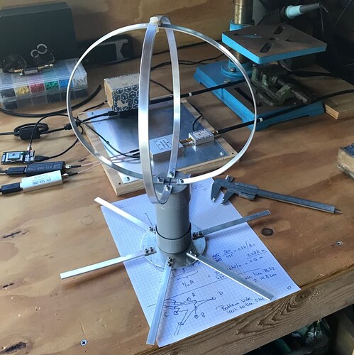

Just build an Eggbeater for UHF and the results are very good.
Both my 431 and 2173 SatNOGS groundstations are connected to it.
Good luck with your setup and feel free to ask further questions.

And also the Antenna looks awesome, I do need to ask for a favor if you could please share any Guides, Schematics, documents that you have referred to or any documents of your Eggbeater project that i can study and implement to make my setup!
Would be awaiting eagerly.
Thanks for the nice words and good to now that all the information is appreciated and used.
Regarding the design that was also shared in the Twitter feed that I shared. Good luck with the DIY.
