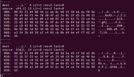

With so many SatNogs observations seeing solid signals on 401.500, I’ve been trying to ID what those signals were.
Using Observation SatNOGS Network - Observation 13759632 , there were clean 2k4 decodes w/ ‘Light-1’ framing:
… I don’t know if these frames match any known sats or what, but wanted to chime in on what we might be seeing there.

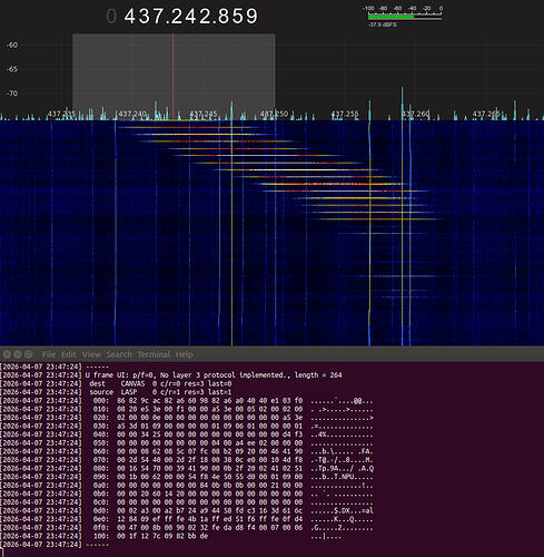

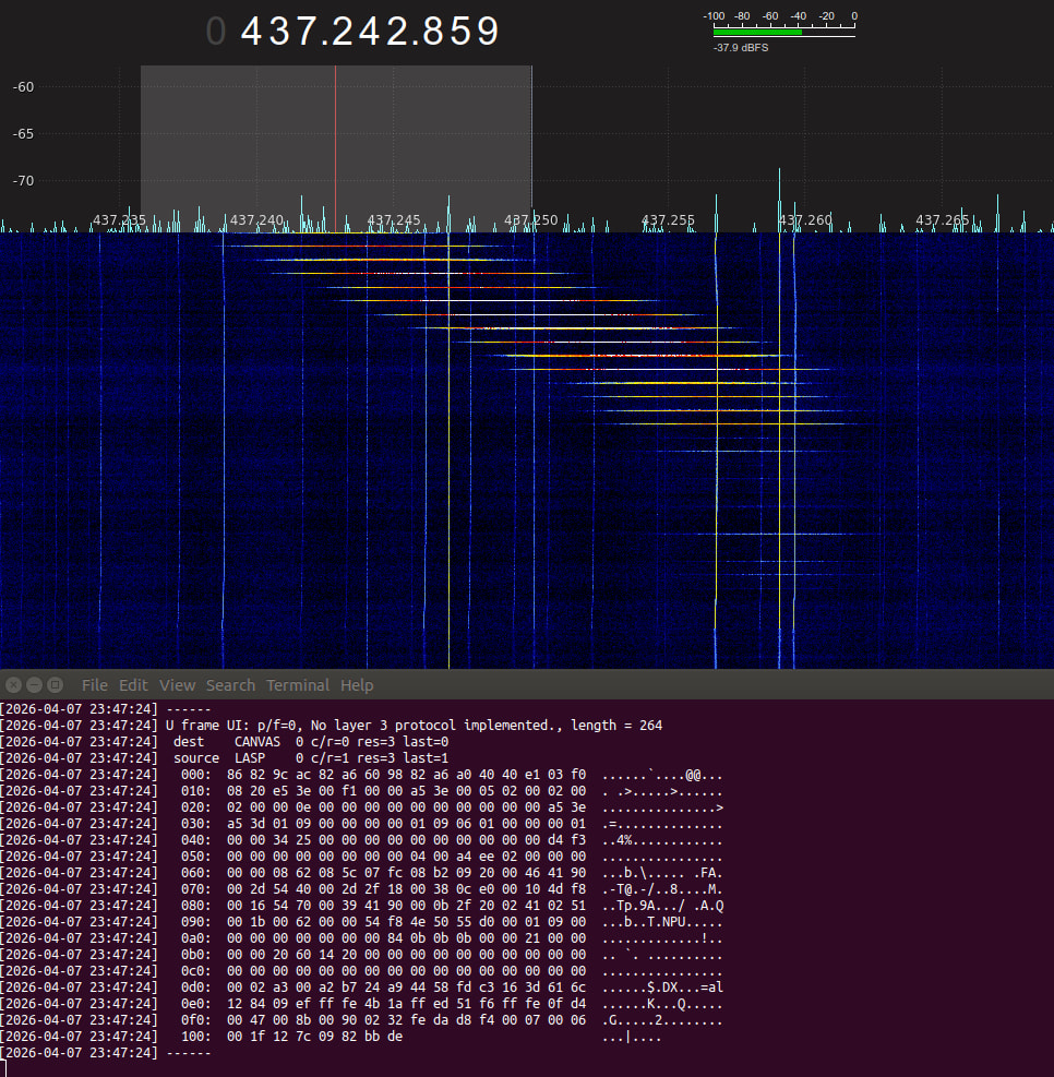

As others have posted, CANVAS looks good. Ahh, the simple days of plain ol’ 9k6 decoding. So now I guess it’s time to move on to help locate some of the objects that aren’t as straight-forward!
