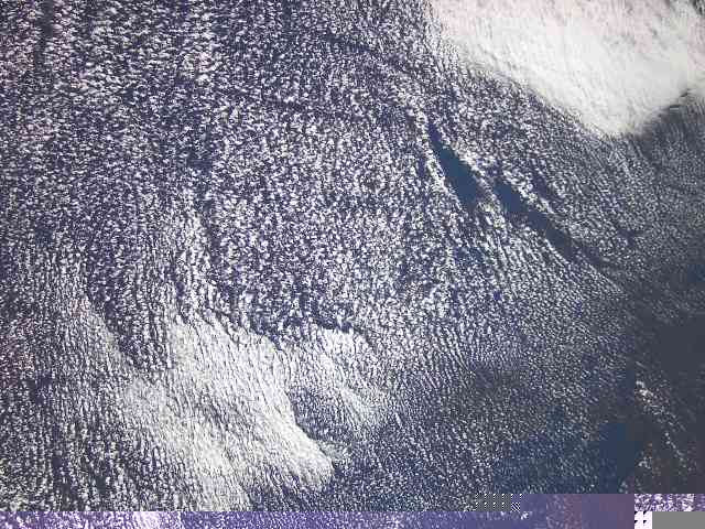

Guess this is from 2026-08-08 21:22 UTC.
There was another one starting at 23:00 UTC.
Seems someone has to handpick every single packet looking into different observations to get the right order.
from multiple observations 2026-08-19 22:54:12 - 23:06:54

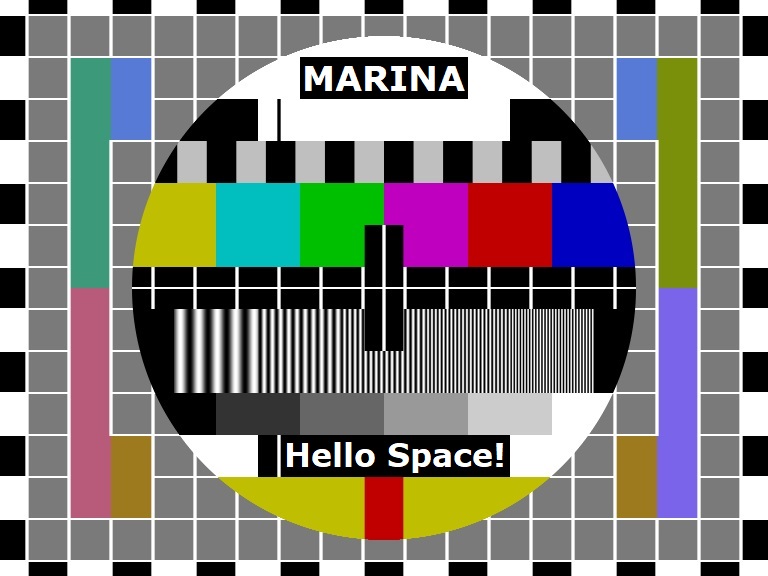

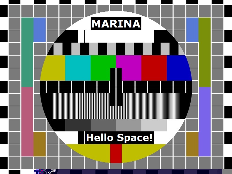

the same picture twice:

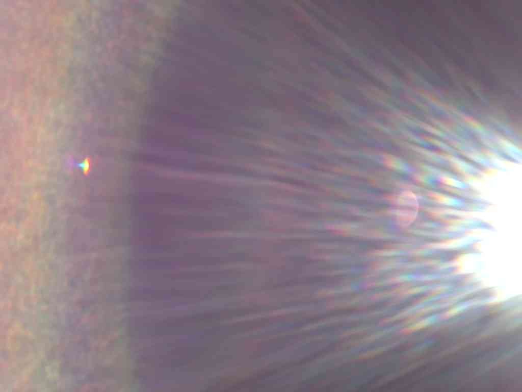

Marina Image 2026-08-20 21:34:28 UTC
2026-08-24 10:25:59 UTC

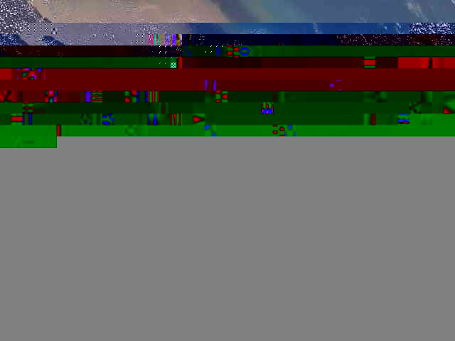

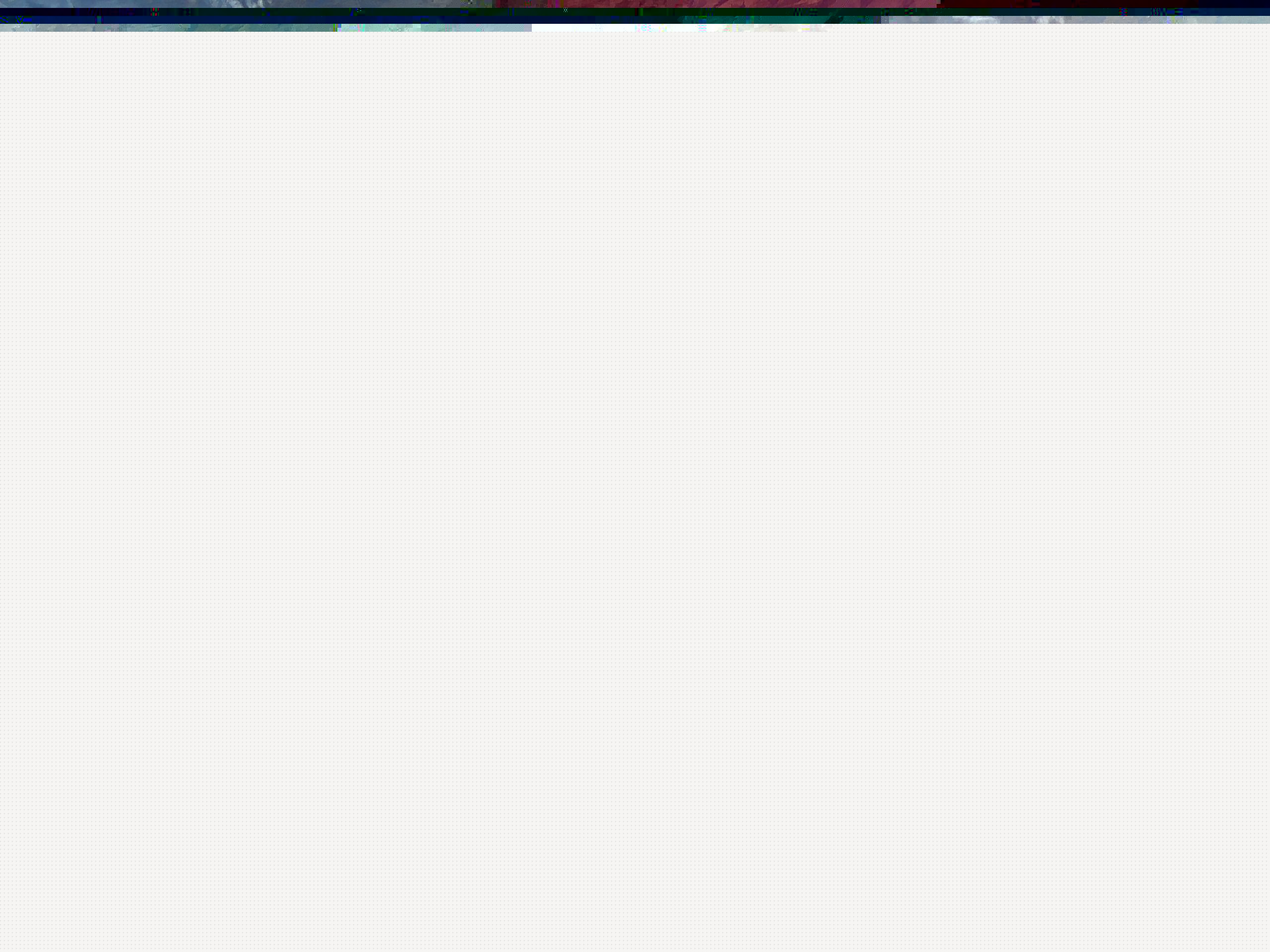

Hi Pavel,
Your decoder with the explanation of the fields from IMG type packets was exactly what I was looking for as I received those packets on 29th during 09:3x pass.
Unfortunately, my decoding started with packet 247 of 680, so I missed the first one with the important information about the jpeg header.
I guess otherwise the decoded 176 packets should have brought up a at least partially viewable image.
73
Daniel

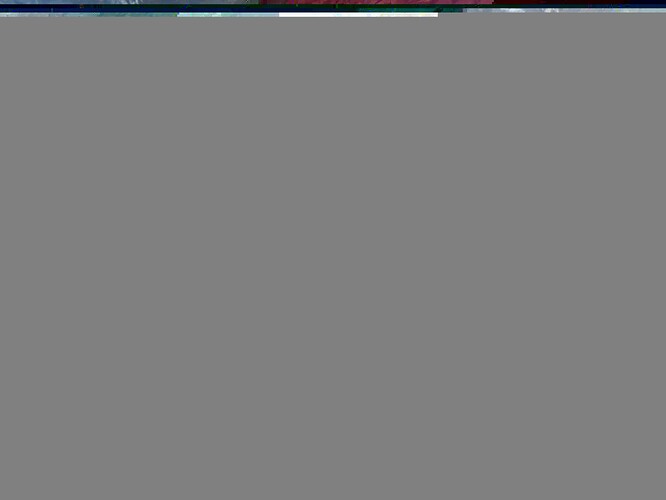

OBS: 15127563
image 2560x1920px, but only few captured/decoded packets:
