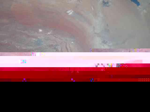

partial images recovered:

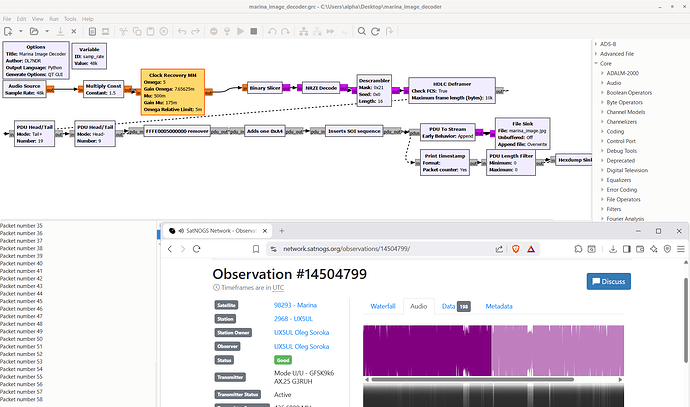

This is not my observation - from my station. I noticed in one observation that there is a lot of decoded data and I discovered JFIF among them.

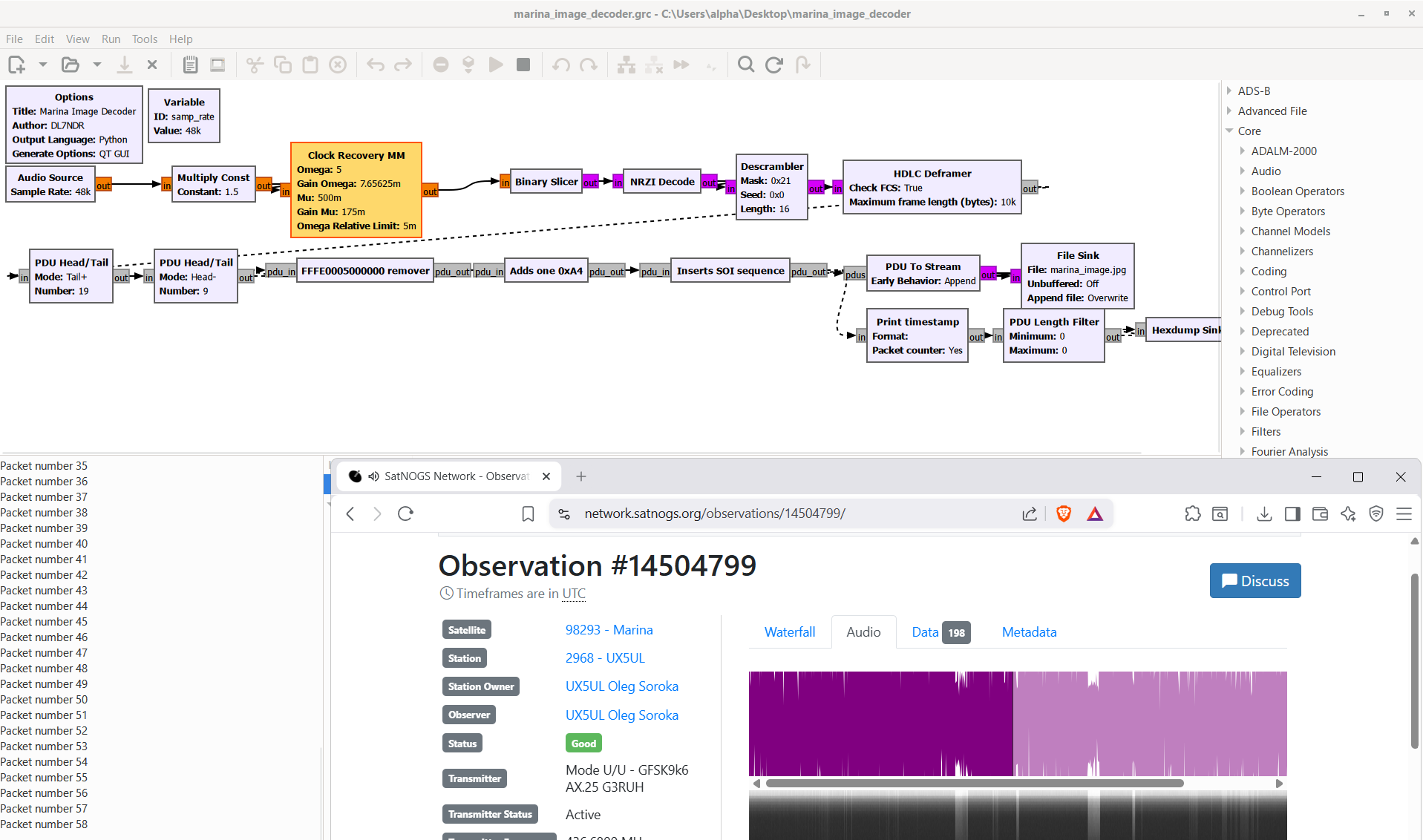

I’ve created a GNU Radio decoder to extract images out of an audio record and to save them directly as .jpg files.
marina_image_decoder.zip (531.3 KB)
It works perfectly for the above mentioned observation.

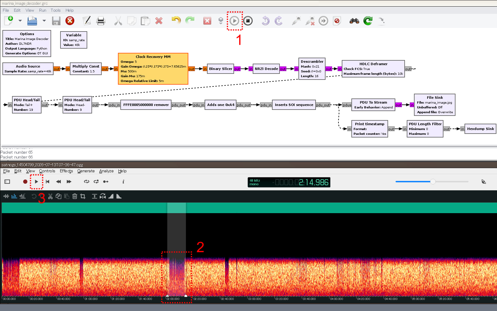

Just download the audio file and play it while the flowgraph is running.
Before playing another area of the audio file holding image data (in the screenshot above it’s right at the beginning), stop the flowgraph, rename the image file and start the decoder again.
Have fun
Daniel

Decoded the image from observation #14504799 successfully with GNU Radio decoder.
Decoded image:

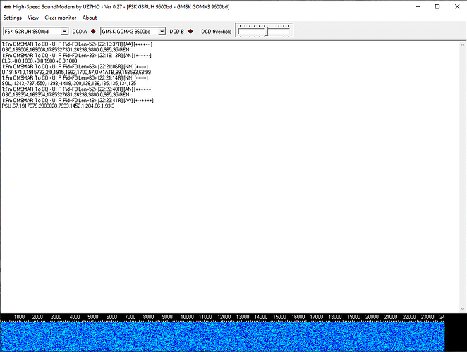

I have attempted to play that audio though a VAC to HS_Soundmodem V0.27 running FSK G3RUH but haven’t had any success. I do copy data live off air thru the same setup. Just now Marina went over. Needs some fine tuning to be 100%.

Just play the original audio file from the corresponding observation.
