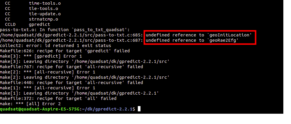

In the directory (~/gpredict-2.2.1/), after the make command, I faced this error:
./configure→ Okay -
make→ Undefined reference to '…' error
Could anyone please help me to compile the Gpredict software with the external library?
