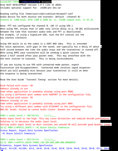

running on latest direwolf - v1.9 it seen device vendor: Argent Data System OpenTracker
