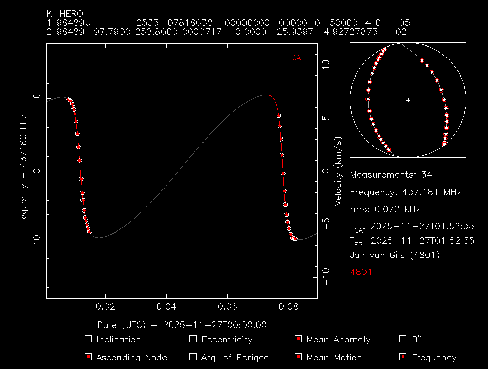

K-HERO seems to be active on 437.180 and not 437.165
K-HERO
1 98489U          25331.07818638  .00000000  00000-0  50000-4 0    05
2 98489  97.7900 258.8600 0000717   0.0000 125.9397 14.92727873    02
# 20251127.01-20251127.08, 34 measurements, 0.072 kHz rms

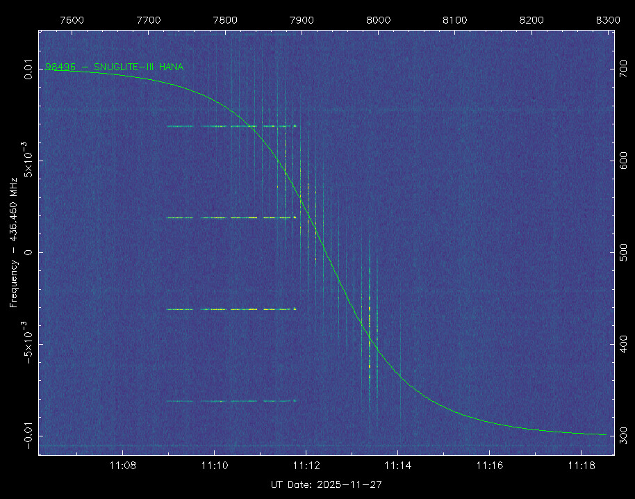

SNUGLITE-III beacon structure [2025.11.26] SNUGLITE-III Beacon Structure | SNU GNSS Laboratory
Two JACK satellites on the same frequency, I need separation to create better TLE

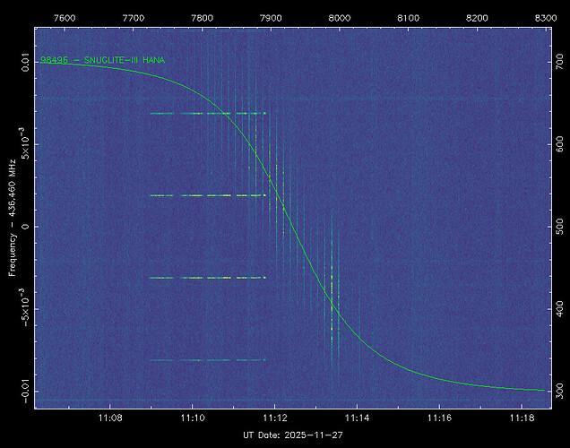

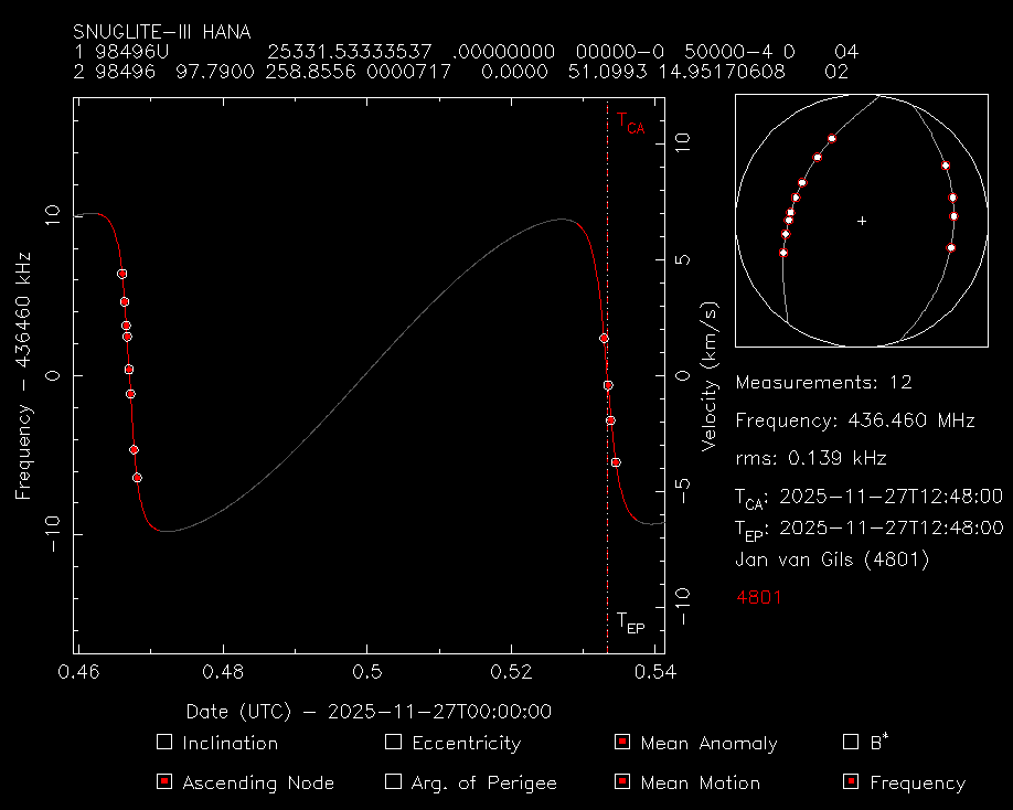

SNUGLITE-III HANA
The signals aren’t very strong over Europe
SNUGLITE-III HANA
1 98496U          25331.53333537  .00000000  00000-0  50000-4 0    04
2 98496  97.7900 258.8556 0000717   0.0000  51.0993 14.95170608    02
# 20251127.47-20251127.53, 12 measurements, 0.139 kHz rms

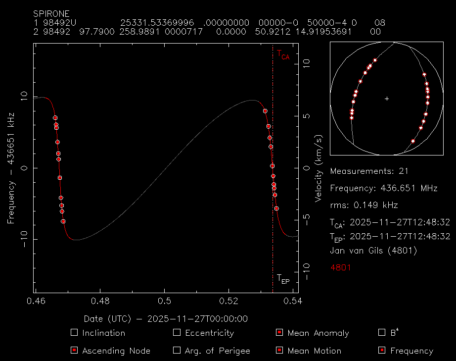

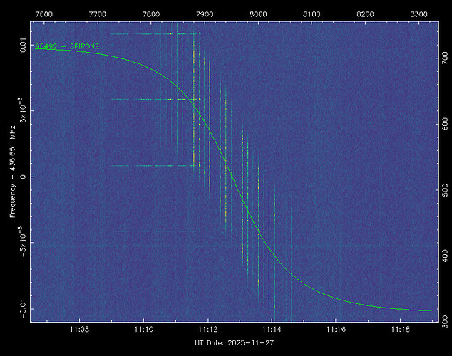

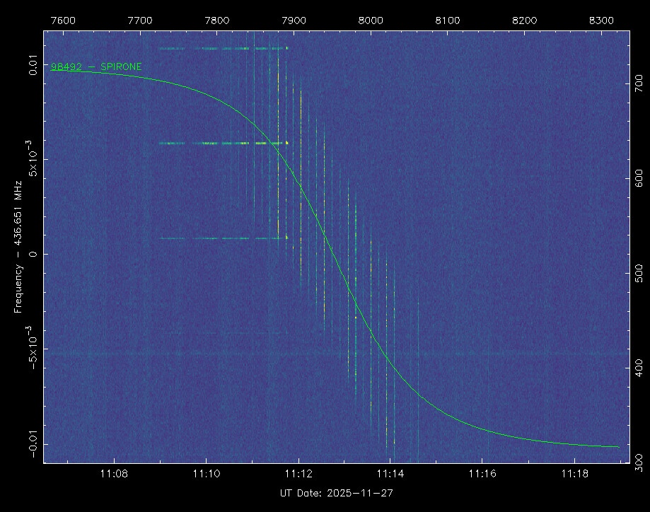

SPIRONE
SPIRONE
1 98492U          25331.53369996  .00000000  00000-0  50000-4 0    08
2 98492  97.7900 258.9891 0000717   0.0000  50.9212 14.91953691    00
# 20251127.47-20251127.53, 21 measurements, 0.149 kHz rms

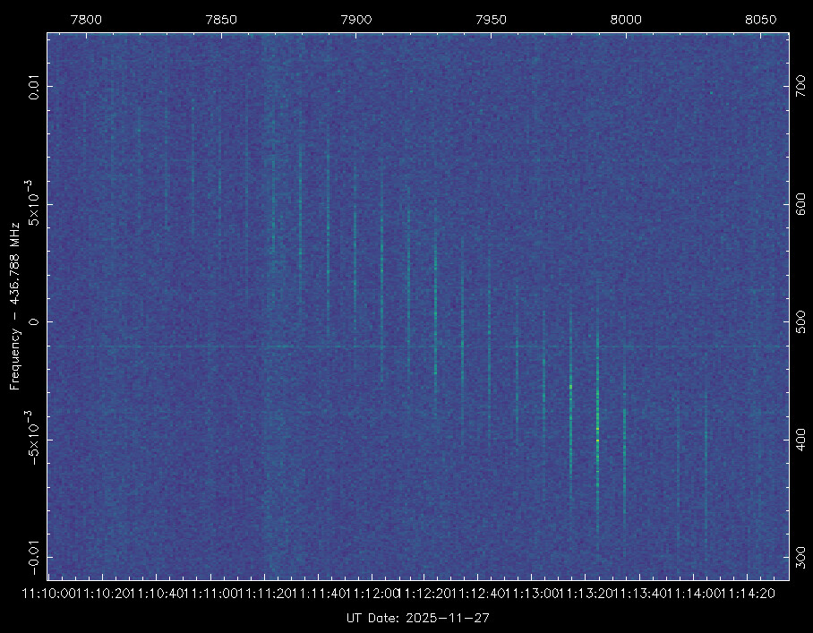

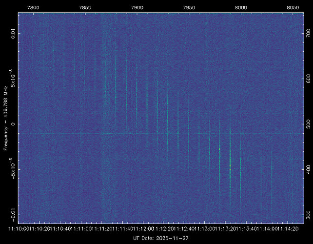

SNUGLITE-III DURI
Very weak on 436.788

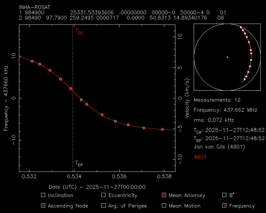

INHA-ROSAT
INHA-ROSAT
1 98490U          25331.53393606  .00000000  00000-0  50000-4 0    01
2 98490  97.7900 259.2495 0000717   0.0000  50.8313 14.89340176    08
# 20251127.53-20251127.54, 12 measurements, 0.072 kHz rms

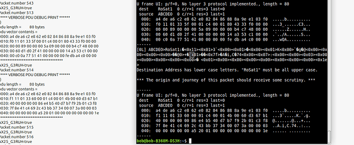

Thanks all TLE updates Jan. Here is INHA-RoSAT sending 9K6 GMSK 1836Z FN41iq 42W

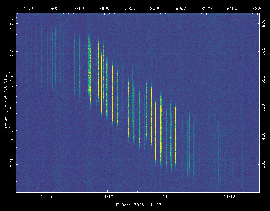

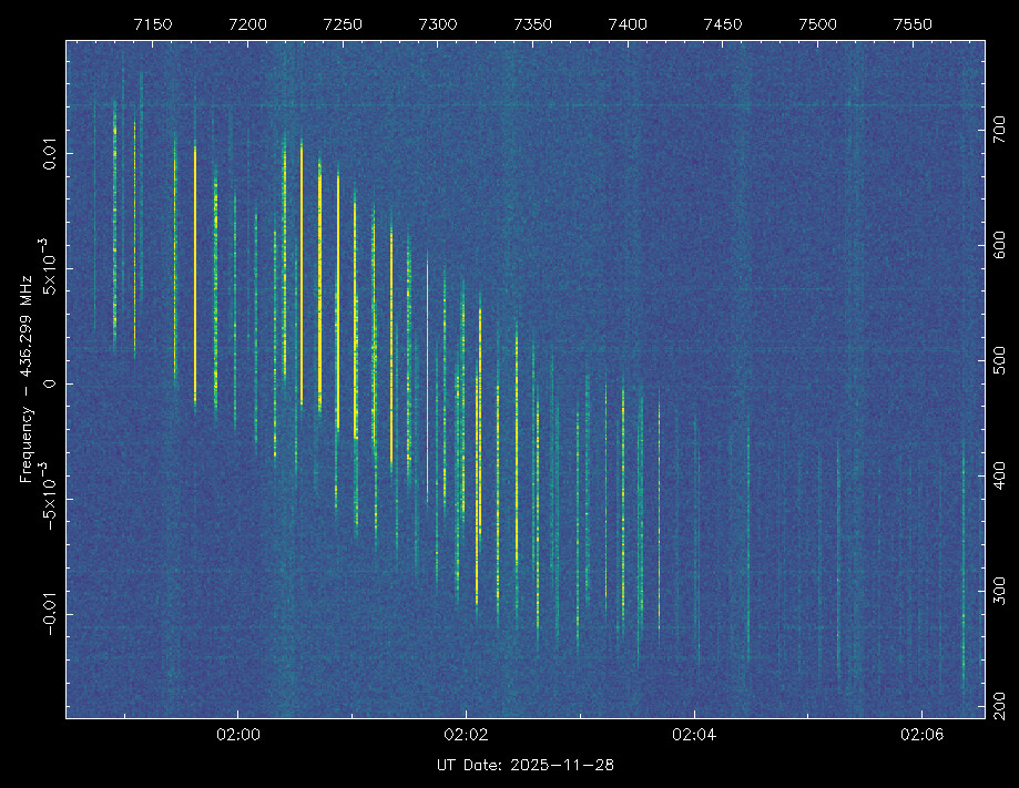

JACK-003 and 004 are already drifting apart
We could try and get some TLE

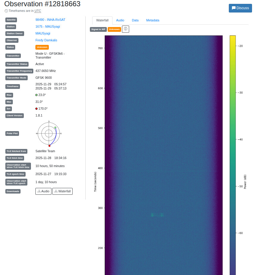

I am in charge of communications for INHA RoSAT.
Thanks to your support, we are successfully monitoring the status of our satellite. We sincerely appreciate your help.
Based on the received GPS data, we reconstructed an updated TLE. We are currently observing about a 2-minute difference compared to the SatNOGS-predicted pass, and we have confirmed signal reception that matches our updated estimation.
We would appreciate it if you could reflect this new TLE.
INHA RoSAT
1 99999U 1800100  25331.80246389  .00000000  00000-0  25992-3 0  9999
2 99999  97.7444 259.2713 0001305 357.3743  54.4032 14.91727050    17
Thank you again for your support.
The TLE changed to use the temporary NORAD ID we use in DB:
INHA RoSAT
1 98490U          25331.80246389  .00000000  00000-0  25992-3 0  9994
2 98490  97.7444 259.2713 0001305 357.3743  54.4032 14.91727050    12
@fredy Thank you for updating the TLE.
Thanks to your support, we have been able to continuously confirm that the signal is being received properly.
For those attempting to receive our satellite’s signal, we would like to share some additional information about INHA RoSAT.
To reduce power consumption, the satellite is currently transmitting only the Audio Beacon.
As shown in the waterfall, the Audio Beacon is visible when transmitted, and it is emitted every 5 minutes.
We would like to once again express our sincere gratitude to everyone who has been receiving and tracking our signal. Thank you!

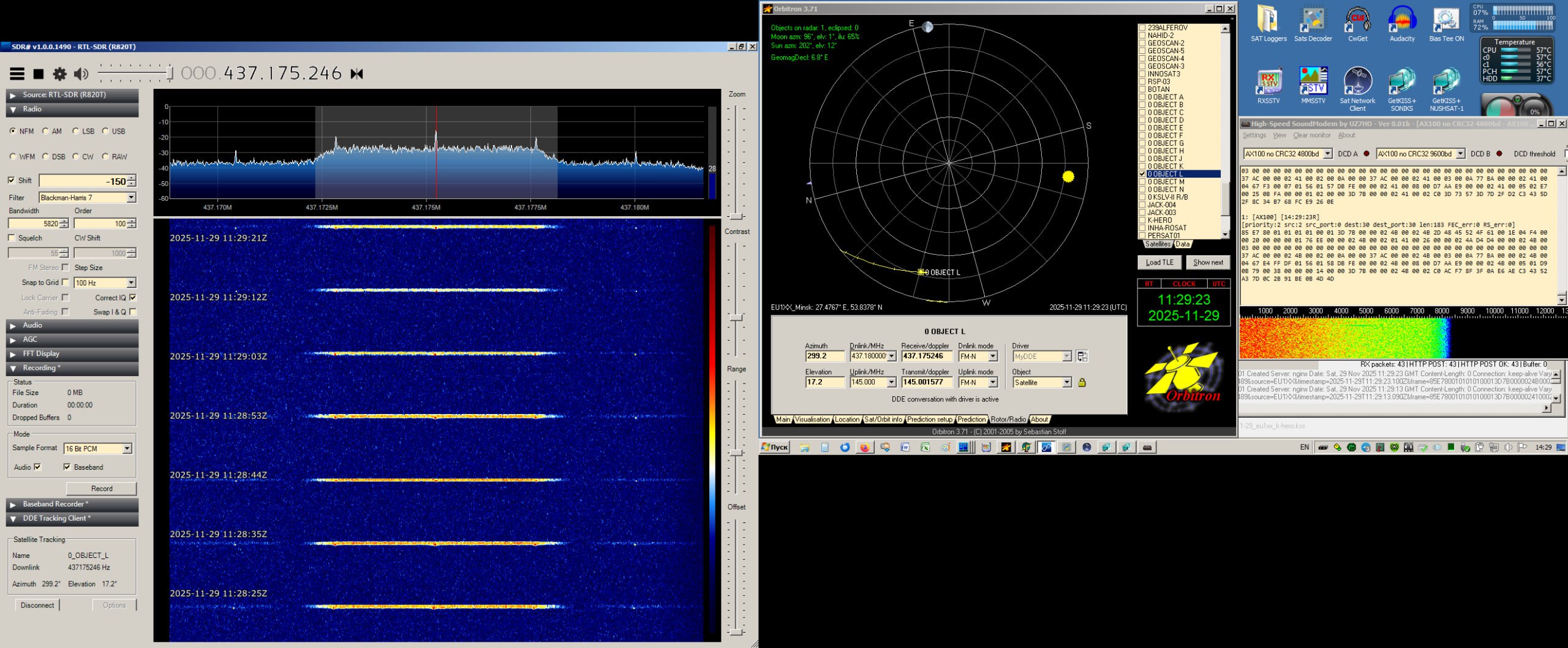

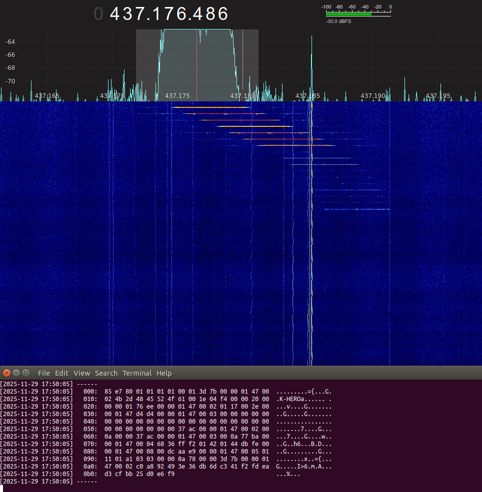

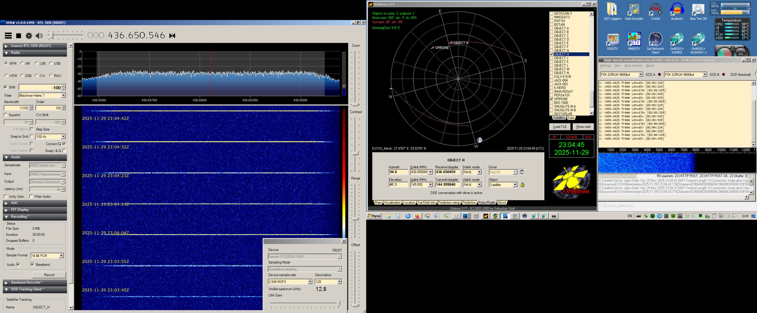

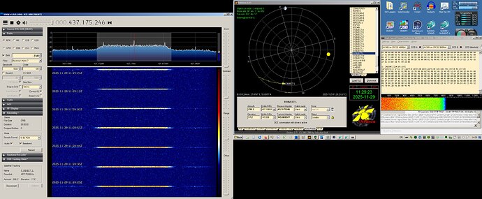

K-HERO frames on 10-sec interval over the Eastern U.S. 1750utc 29-Nov

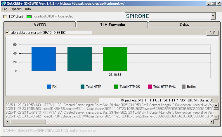

SPIRONE is suitable object 66657 (2025-274-H) now
