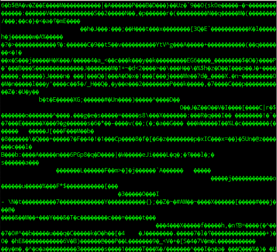

Sdrpp → udp dump 7355 at 48khz at 127.0.0.1 → gr_satellites and I don’t see any packets come through.
Sdrpp → udp dump 7355 at 48khz at 127.0.0.1 → nc -l -u 127.0.0.1 7355 and I don’t see any packets come through.
Sdrpp → udp dump 7355 at 48khz at 127.0.0.1 → generic python socket application. I see packets come through.
Not sure what is the problem and I have tried other applications such as sdrangel and encounter similar issues.

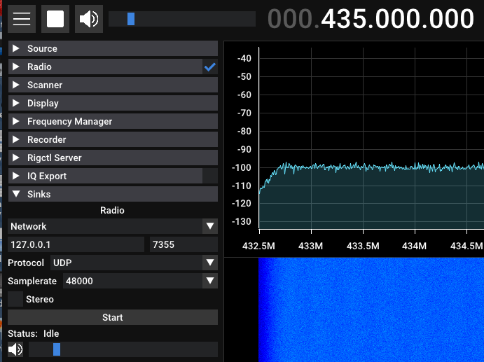

So the whole goal is to be able to stream the udp sink of a sdr software to gr_satellites so that I can decode packets when doing manual tests. Eventually I would also like to do this same process with SDRangel since with this ground station I am trying transmit to digipeater and need the transmit functionality of SDRangel and would be nice to have proper receive decoding at the same time.
Right now I am trying to utilize the radio sink in sdrpp and as mentioned before and I can only see the udp packets come through with python sockets.

Thanks for the reply, so you want to use the demodulated audio as input for gr_satellites.
Using the following command nc -l -u -p 7355 127.0.0.1 I do see packets being received after clicking start in sdr++
A remark, this will not work when you replay an recorded IQ file because sdr++ isn’t adding a throttle block when replaying and using the Radio network sink.
Maybe consider audio routing towards gr_satellites or use an IQ file as input.

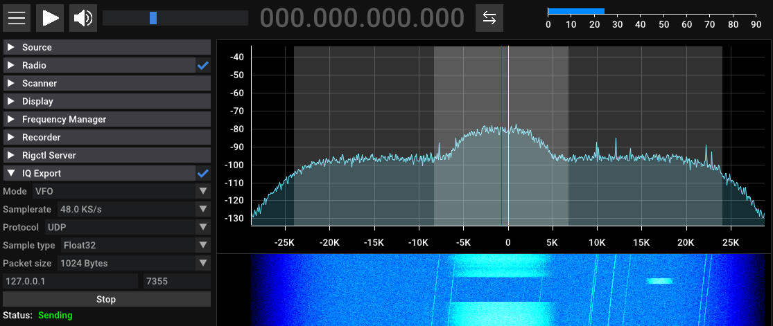

The sdr++ IQ export module is also an option.
Replaying a GRIFEX IQ recording and using the following gr_satellites cli command.
gr_satellites GRIFEX --samp_rate 48000 --udp --udp_raw --udp_port 7355 --udp_ipv4_only --iq

Okay I think it must have been a udp packet format issue (wasn’t using the float32 export with the iq export from sdrpp). Ultimately, I ended up using an internal audio loopback as that proved to be more reliable. Thanks for the help.
