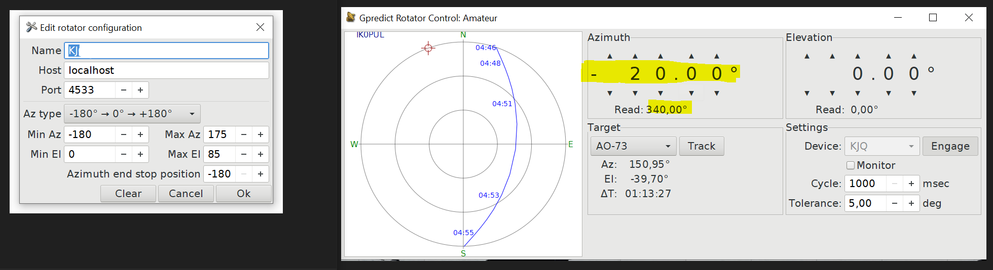

Hi all,
I’ve the configuration shown on the left and on the right what I see when rotator is engaged.
The issue is with negative AZvalues
When I manually set to a negative angle (eg -20), the rotator moves correctly CCW and I see Gpredict receives below message back from local TCP server ( after Gpredict query position )
-20.00
0.00
however the READ field shows 340, instead of -20 ( = 340 - 360 )… it seems Gpredict is wrong with any negative Az value.
is there any known bug with Gpredict with AZ TYPE -180 → 0 → +180 ?
