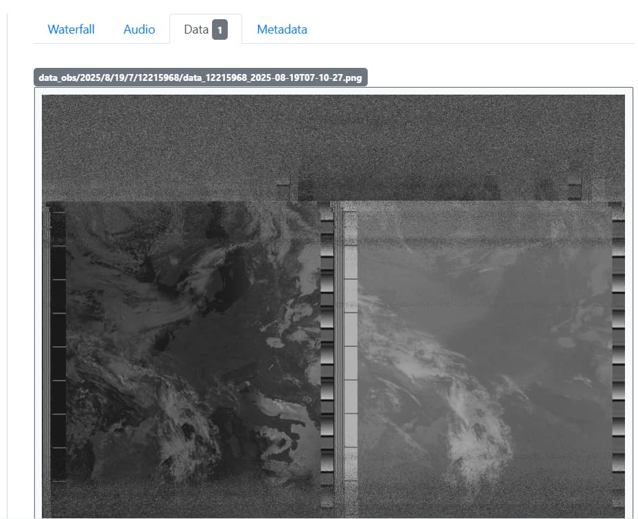

Hello, I’ve noticed that all the DemodData images and waterfall images are broken, when i go to open a data image directly I see that the aws link fails as the site can’t be reached.
Hello,
Did you tried with other browsers or in private mode ?
For me, on my side everything seems to be fine :
yes I’ve ruled out Chrome browser issue by using private and also using Safari as well as different computer. The issue is for all my history not just recent results so it’s a display issue
What you get instead of the image is the alternative text defined by the alt attribute which happens when for some reason you cannot view the image.
This could happen due to slow connection, an error in the src attribute (the link for the image), or if you use a screen reader.
Maybe you can find more details or errors in developer console of your browser, let me know if you want help with that.
It also works for me with Firefox and Chromium browser. Maybe it is (was) an intermittent issue? Do you still experiencing it?
Interesting, I get ERR_CONNECTION_RESET on all links in observation history when using my wifi but not 4G, so either my ISP or issue with my wlan/firewall, let me investigate.
When running a traceroute from my home connection, I reach the satnogs server network via Cloudflare and GRNET, but the final hop returns !Z — “communication administratively prohibited” — which suggests my IP is blocked at the destination firewall.
Hello @m6lzt ,
It appears that the host you are targeting at your traceroute is not the correct one. Which command do you use exactly?
Hi there, thanks for getting back, traceroute satnogs.org
The issue is resolved thank you.
