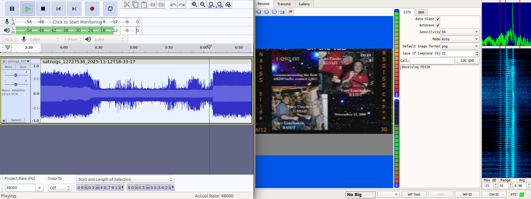

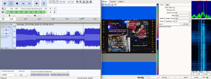

Thanks for posting that observation! Hope they get the SSTV downlink running again, but it was nice to check out one of the images from that recording.

Hello! What tooling is this? Currently looking for better ways to handle SSTV manually.
Looking forward to seeing everyone’s images here.
On linux, I use QSSTV for sstv decoding.
It could be particular to my setup, but I’ve found one issue that is good to know.
I normally leave my mode set to AUTO, but if you change it for some reason, be sure to close the program and then launch it again fresh.
In the past, when I have foolishly changed to something other than AUTO, I would get no decode. Simply closing the app and re-starting it, the manual setting to some specific mode works fine. Ditto going from a single mode TO the auto setting… after that change, stop & re-start the app.
But again, AUTO is where I leave it now and everything works great.
