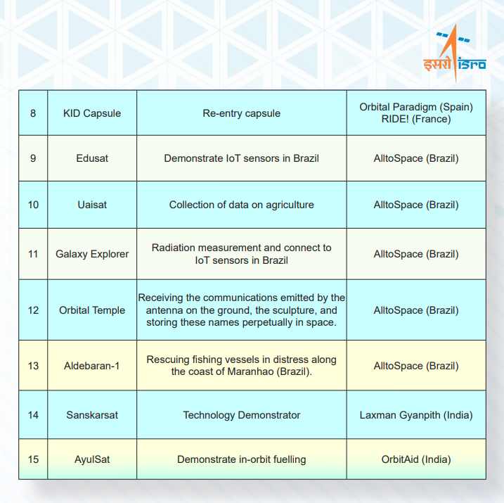

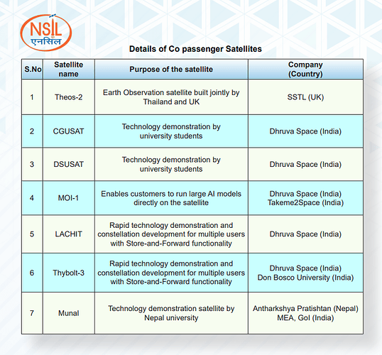

Looks like we have a ride-share mission from ISRO scheduled for 12-Jan-2026.
From their Media Brief (https://www.isro.gov.in/media_isro/pdf/PSLVC62/PSLV_C62_Brochure080126.pdf ), here are the sats that we can hope to see downlinks from:
… there are some very interesting sites that appear to be related to some of these satellites (or previous members of the same family)…

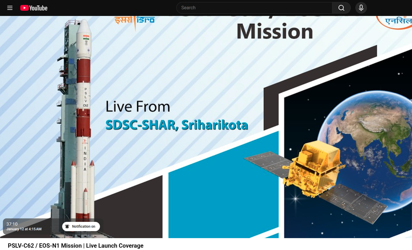

And the Launch LiveStream URL:

Hi Scott,
Thanks for sharing the information on this upcoming launch.
I had a quick look but couldn’t find any frequency information on the satellites in the list.
Only Thybolt 1/2 are launched earlier and where also IARU coordinated.
Did you already find some frequency details ?

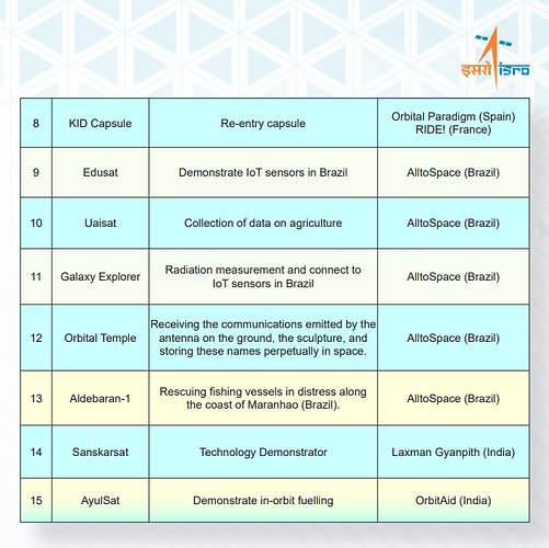

I am familiar with the Brazilian satellites, which are:
From what I know ALL Brazilian satellites should transmit at 468.5MHz (I know that UaiSat and Aldebaran should transmit in LoRA). Both are on the TinyGS network

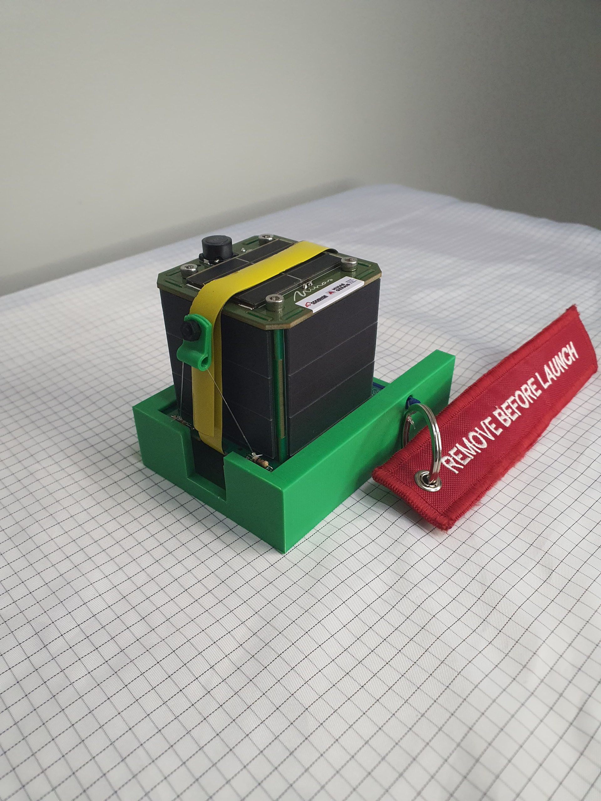

Brazilian satellites are within the Constellation A2S_1 registered with the ITU.
Here are some images of UaiSat and the mission emblem. If you need more information, don’t hesitate to ask!

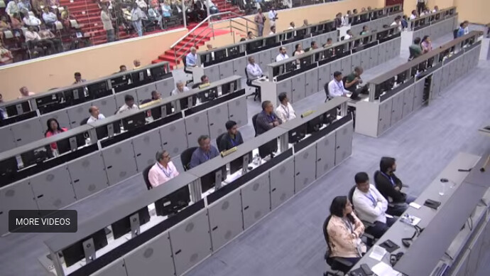

In the live stream around 4:57 UTC time where it shows a view from the control room, there is a live feed from camera on the last stage(?) and shows a quick spin (earth shows up and disappears), like the last burn was done uncontrollable (my speculation).
Wondering now if the payload were deployed in the scheduled time or not, independently from the last stage status, and if yes what orbit they will follow.
Looking forward for the official announcement to find out what happened.
