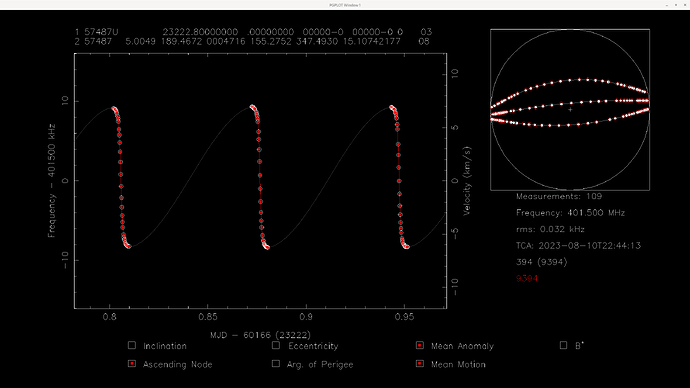

Exactly! We use the propagate tool from sattools by @cgbsat.
Just in case that is not clear, the process is to fit the existing TLE to the observations data, then propagate the fitted TLE to an epoch near to the data epoch and then re-fit them and generate the final TLE.

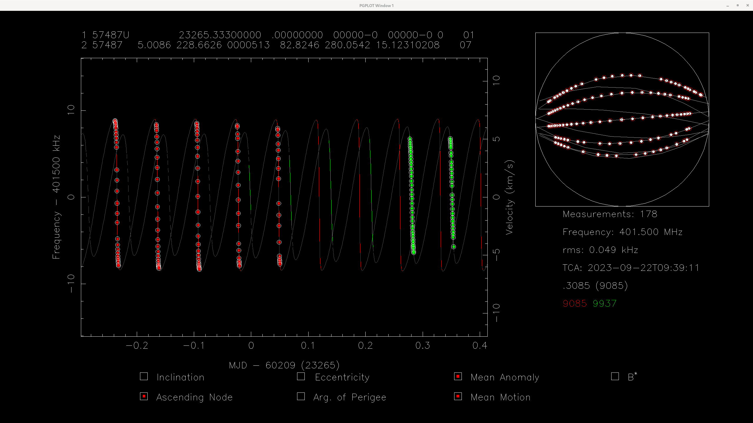

Thanks for the explanation of the process! We tried it and noticed that when we used propagate, the eccentricity field became 0.
To be sure of the steps:
We use the existing observations data and use satnogs-waterfall-tabulation-helper.py with rffit to fit the observed data into the TLE.
With the generated TLE from step 1, we use propagate and for -t field, we use a close by time of the observation that we had on satnogs. For eg: SatNOGS Network - Observation 8239908, we use 2023-09-29 03:17:05.
With the new TLE generated in step 2, we run rffit again to fit the observation into the TLE. We use the new TLE by replacing the TLE found inside $SATNOGS_TLE_DIR.
Following the above steps, we can generate TLE with updated epoch however, the eccentricity value would be 0. Is this method correct?
