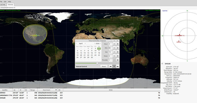

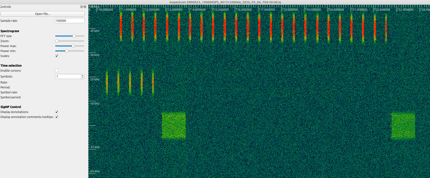

While tracking ERMIS-3 on 401.312 MHz on 4April26 0944Z over EM12kw, during part of the pass two additional signals were also observed. ERMIS-3 was decoded as 9K6 AX100 as expected.
Just up the band however, two additional signals were observed. Up ~18Kc from IQ center, a burst of 5 frames was seen. This was the only time that these signals on ~ 401.330 MHz were observed during the pass. These decoded as 9K6 AX.25 G3RUH true frames. Dest - ESGS01 and Source ABCDEF, which maps to EMISAR which is predicted to be on 401.334 MHz.
To my surprise, the frames seen ~ 40Kc up from IQ center also decoded as 9K6 AX.25 G3RUH true frames. Same Dest - ESGS01 and Source ABCDEF !
Thus, it appears that Unknown1-T16 may be EMISAR transmitting on a second frequency. Be great if others could confirm or offer a different explanation.

I’m part of the EMISAR operators team at RISE. I confirm that the 5 beacons that N6RFM posted in the first post were from EMISAR. We were able to decode them successfully, big thanks for posting them!
I also confirm that there’s only one transmitting frequency on EMISAR, and Unknown-1 is another satellite, transmitting much more often than EMISAR. Our beacons are 500s apart (a sequence of 5 parts), but our overall power budget is slightly negative while we are detumbling, and therefore the satellite is turned off quite often, until the battery is (partially) recharged.

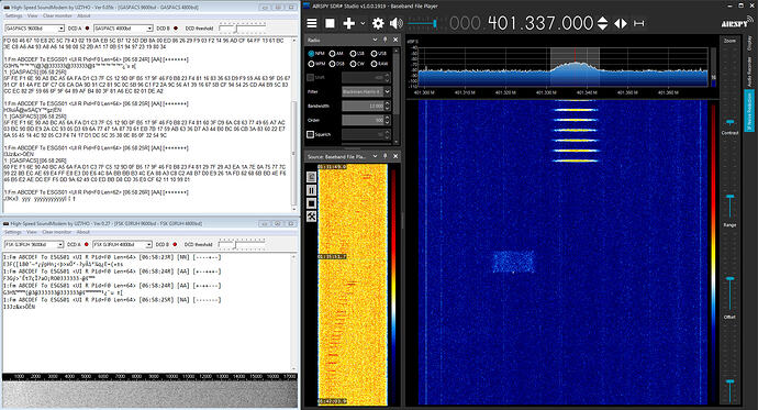

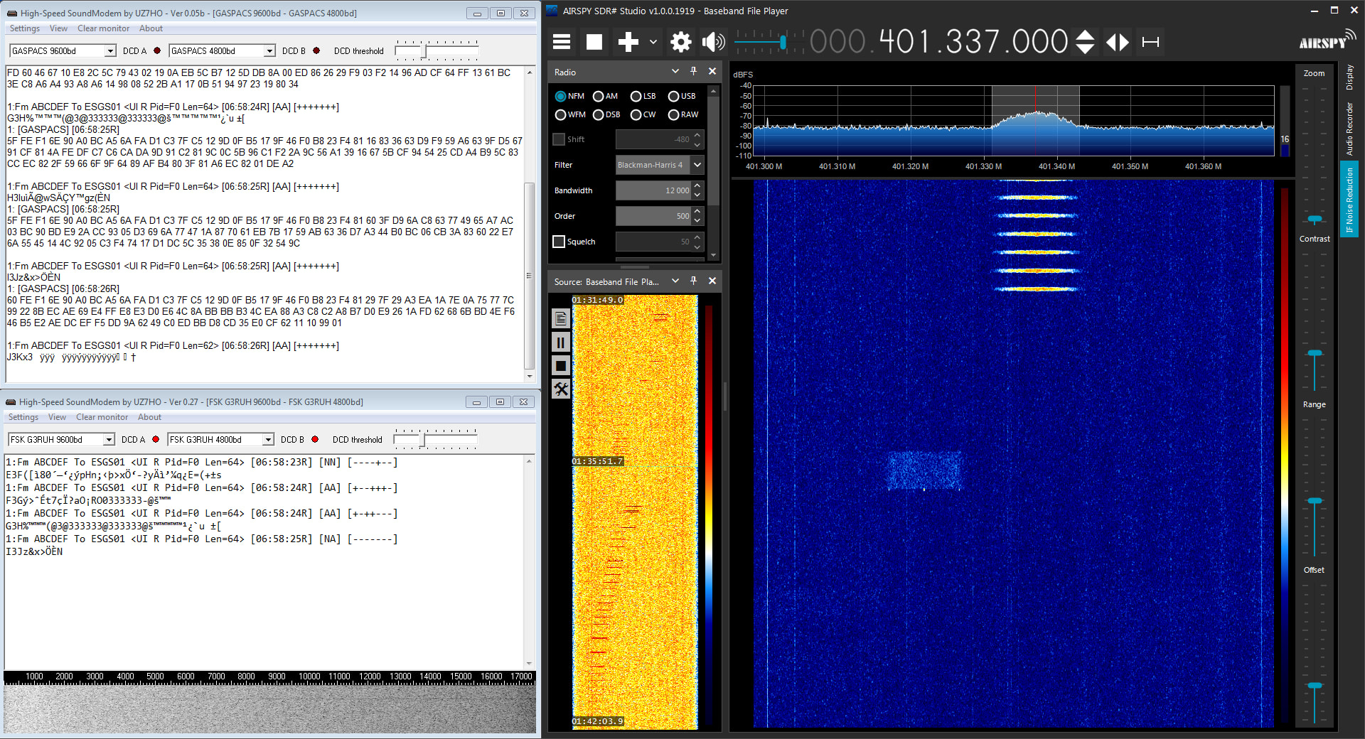

I received the signal from EMISAR on April 1st at 13:13 UTC but it could only be demodulated with the GASPACS version of UZ7HO’s SoundModem.
No results with HS SoundModem Ver 0.27 in FSK G3RUH 9600bd.
This has been observed with all satellites made by EnduroSat, some packets to be demodulated only with the GASPACS SoundModem.

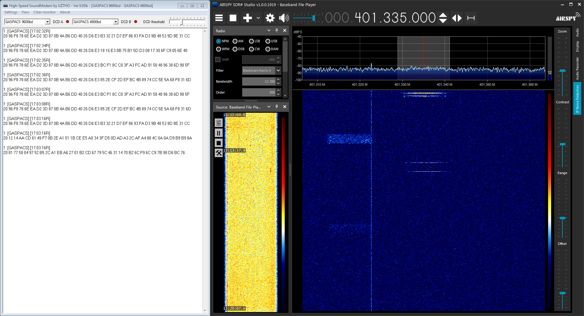

It is also notable that the last three packets have a different header:
20 96 F8 78 6E EA D2 3D 87 0B 4A B6 DD 40 26 D6 E3 B3 32 21 D7 EF 86 93 FA D3 9B 48 53 9D 9E 31 CC
20 96 F8 78 6E EA D2 3D 87 0B 4A B6 DD 40 26 D6 E3 18 16 E3 0B 75 B1 5D D3 08 17 30 6F C9 05 6E 40
20 96 F8 78 6E EA D2 3D 87 0B 4A B6 DD 40 26 D6 E3 BC F1 8C C0 3F A3 FC AD 91 58 48 96 38 6D 98 5F
20 96 F8 78 6E EA D2 3D 87 0B 4A B6 DD 40 26 D6 E3 85 2E CF 2D EF BC 4B 89 74 CC 5E 5A 68 F8 31 6D
20 12 14 AA CD 61 49 F7 0B 2E A1 51 1B CE E5 A0 34 3F D5 0D AD A3 2C AF A4 88 4C 0A 0A D9 B9 B9 8A
20 81 77 58 04 97 52 B5 2C A1 EB A6 27 01 B2 CD 67 79 5C 46 31 14 70 B2 6C F9 6C C9 7B 98 D6 BC 76
40 A3 BB C8 81 57 2F 95 50 75 22 45 DC 4C 12 20 D2 45 A7 15 AB 92 28 A5 78 20 46 21 62 FF B9 ED 9B BC 6C C2 27 50 80 34 36 1F A7 43 69 78 EE D8 29 24 57 80 83 D4 A2 1C D8 9D E5 90 48 3C D6 08 6A
Any comment on this?
Hi, and thank you for the info. My colleagues confirm that during that time we were attempting to send TCs to the satellite, and this is the response (“sync“ packets - for the handshake, and probably a partial response too). We don’t have visibility inside this protocol and we can’t decode it, as it’s Endurosat proprietary.
Also, we use WFM instead of NFM to receive and decode our satellite (if that matters).
Regards,
Claudiu (RISE)

this specifically, is a bad idea. what will happen is the following blocks will see a super weak signal drowned in noise.
also, note that gr-satellites has a endurosat deframer with example useage on GASPACS.yml.
you can also adjust the deviation, usually 2400 for 9k6 transmission on the ones I’ve seen, ax.25 example.
