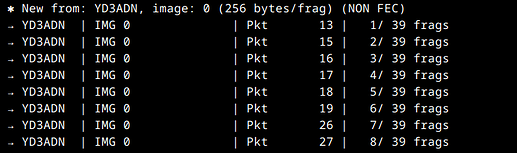

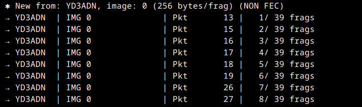

yes. but not full image.. maybe around half . there is jpg file at output folder
maybe you can share the log.txt file here
log.txt (1.3 KB)
