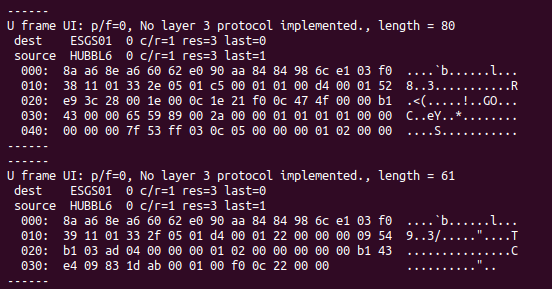

What kills me is that a standard FSK / AX.25 flowgraph decodes the audio from a good SatNogs observation perfectly.
… however, my own recordings, no matter how strong & clear, do not. I can’t figure out what I am doing differently… I’ve decoded thousands of other 4k8 packets just fine.
I do notice that the SatNogs Observation audio results in a much more narrow spectrum than my own audio recordings, so I didn’t know if it was being filtered, using USB demod, or what. Quite a mystery that I’ve spent endless hours on!

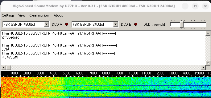

I also gave the UZ7HO sound modem a try
