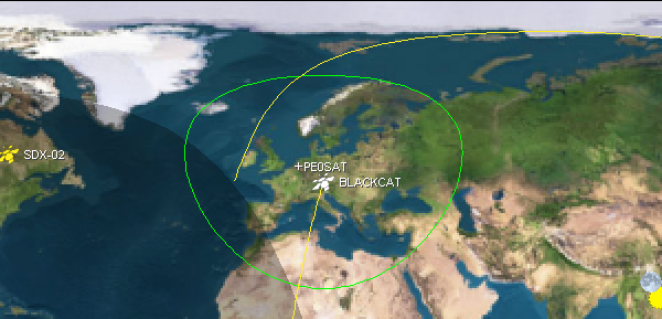

Can you tell something about when and where the satellite is active and with what kind of frames?

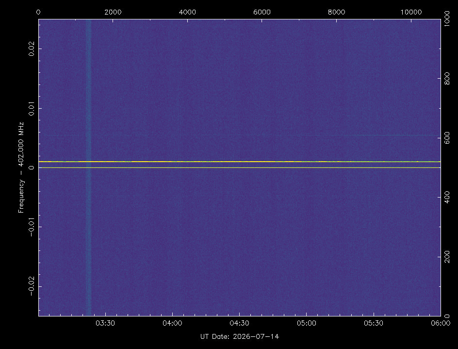

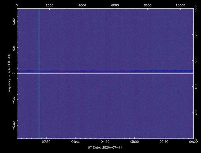

I have looked at 402.000 MHz when BlackCAT was passing Europe on the 13th and the 14th but there where no signals present.
It’s very likely that the satellite is not currently transmittinig on UHF. Our main downlink is with KSAT over s-band but we are trying to use UHF stations as a way to send out rapid alerts for gamma ray bursts. This was not the initial plan, but something we are doing as a stopgap
