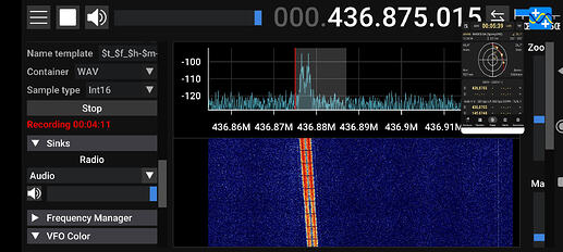

it try create python script, to convert from satnogs iq raw to demodulated usb. but not perfect and clear as if we convert it with sdr++ etc app.
i share here, maybe friends here can make it better

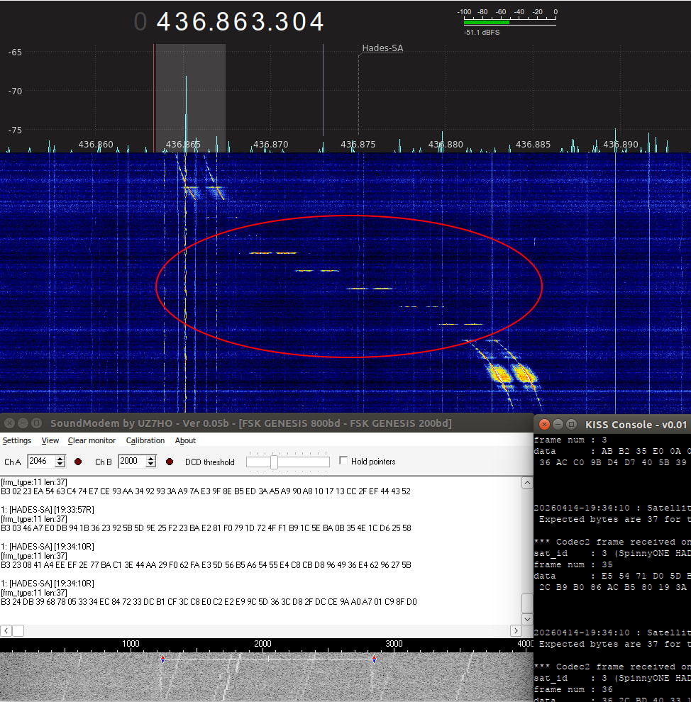

I received signals from the HADES-SA satellite, but I was only able to decode images on the first day. During subsequent attempts, SoundModem failed to recognize the signal. I suspect this might be due to the Doppler effect, as I noticed the waterfall display in SoundModem shows a constant frequency shift.

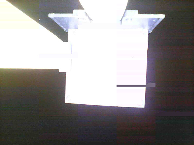

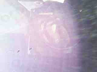

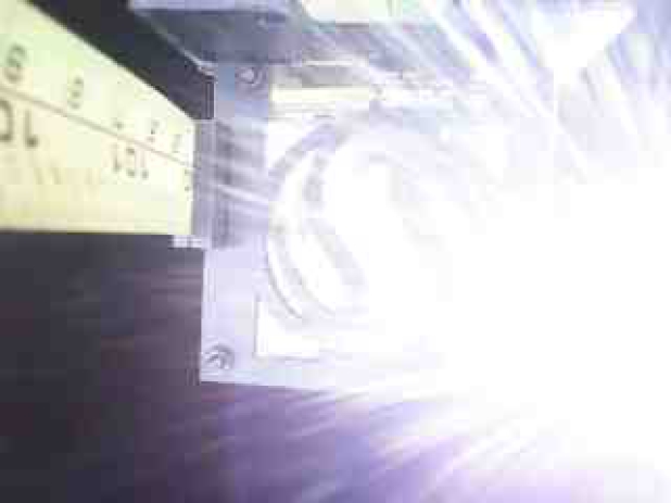

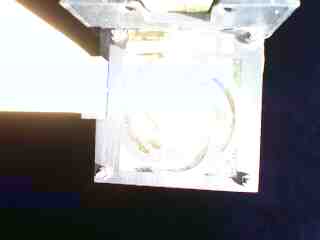

Not surprisingly (since he provided the SoundModem + the decoder app to create the .bin files), UZ7HO has been working on receiving & assembling the composite image from all these smaller image downloads. I wonder what we’re still missing and since it’s a bit difficult to see due to the exposure, what it is we’re looking at? Anyone figured it out?

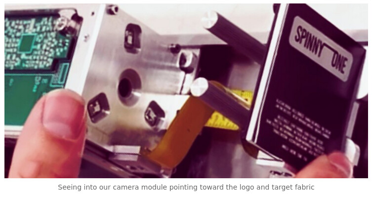

selfie cam, actualy not selfie. but pointing to an experimental fabric with Spinning Around big logo :pensive_face:
Oh! Excellent - I’d not seen a version w/ such improved contrast.
Very cool!
“Can the sat operator shift the Spinning Around logo a little bit so it doesn’t cover the view/scenery behind it?” :pensive_face:
Soon…. :wink:

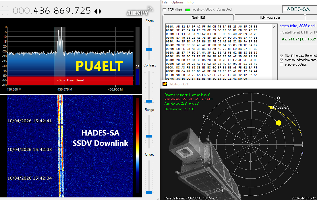

I copied the new image #016 perfectly on the first try, without any errors!!! just now on the HADES-SA

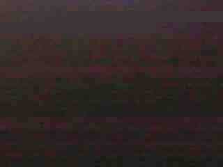

Only got a portion of the new image today; when highest in my sky, the satellite changed to telemetry packets. Can’t win them all!
Image #016 received in :greece:. It took two days to receive all the packets.

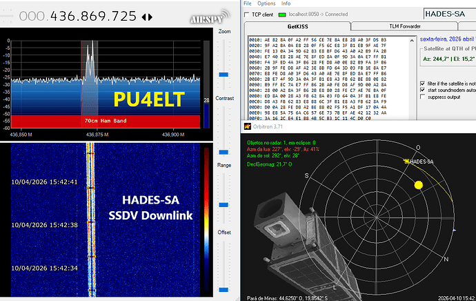

Hades-SA. 01:30 UTC. Image 032 (28 packets) + telemetry. Audio - same packets 0-36. Done in one try - had to sacrifice my sleeping time)
RTL SDR V4 + 7 el. Yagi
