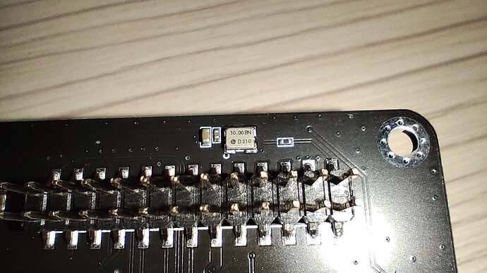

Hello, does anyone has HackRF experience with external clock? And if one knows HackRF Portapack H2 has a built in TCXO on the screen module? I open the case and found something that looks like and labeled as 10 MHz oscillator. The pins that usually used to plugged in TCXO module was used by the screen module.
