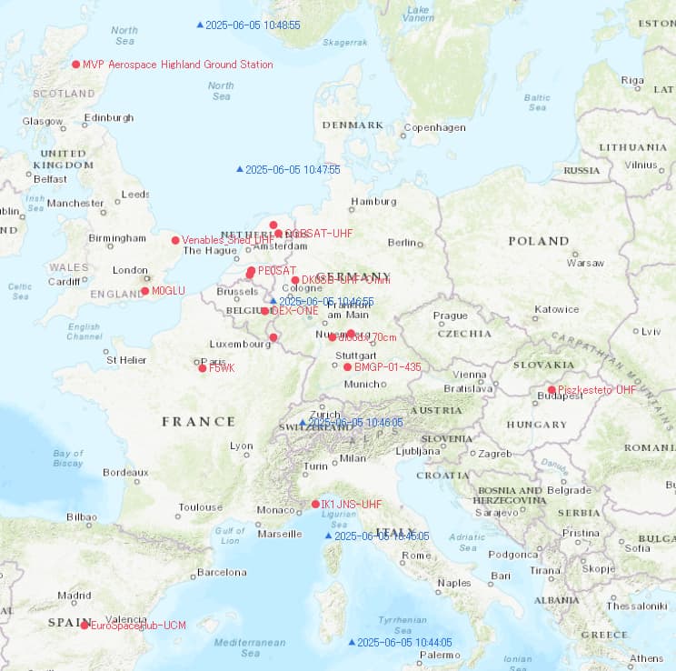

I took these 6 continuous GPS data points:
2025-06-05T10:44:05 - 2025-06-05T10:48:55
GRBAlpha’s Dashboard
2025-06-05 10:48:55|86A240404040E09E9A728EA4847F03F04750533A313734393132303533322C31393430302C35382E36313931322C322E35303636392C3235343234362E30
GPS:1749120532,19400,58.61912,2.50669,254246.0
2025-06-05 10:47:55|86A240404040E09E9A728EA4847F03F04750533A313734393132303437322C31393337302C35342E37313031392C342E34363637382C3235333637362E33
GPS:1749120472,19370,54.71019,4.46678,253676.3
2025-06-05 10:46:55|86A240404040E09E9A728EA4847F03F04750533A313734393132303431322C31393334302C35302E37373837312C362E31323539302C3235333036302E35
GPS:1749120412,19340,50.77871,6.12590,253060.5
2025-06-05 10:46:05|86A240404040E09E9A728EA4847F03F04750533A313734393132303335322C31393331302C34362E38333030312C372E35363636362C3235323430392E35
GPS:1749120352,19310,46.83001,7.56666,252409.5
2025-06-05 10:45:05|86A240404040E09E9A728EA4847F03F04750533A313734393132303239322C31393238302C34322E38363737322C382E38343436342C3235313736332E38
GPS:1749120292,19280,42.86772,8.84464,251763.8
2025-06-05 10:44:05|86A240404040E09E9A728EA4847F03F04750533A313734393132303233322C31393235302C33382E38393433372C392E39393839352C3235313132392E38
GPS:1749120232,19250,38.89437,9.99895,251129.8

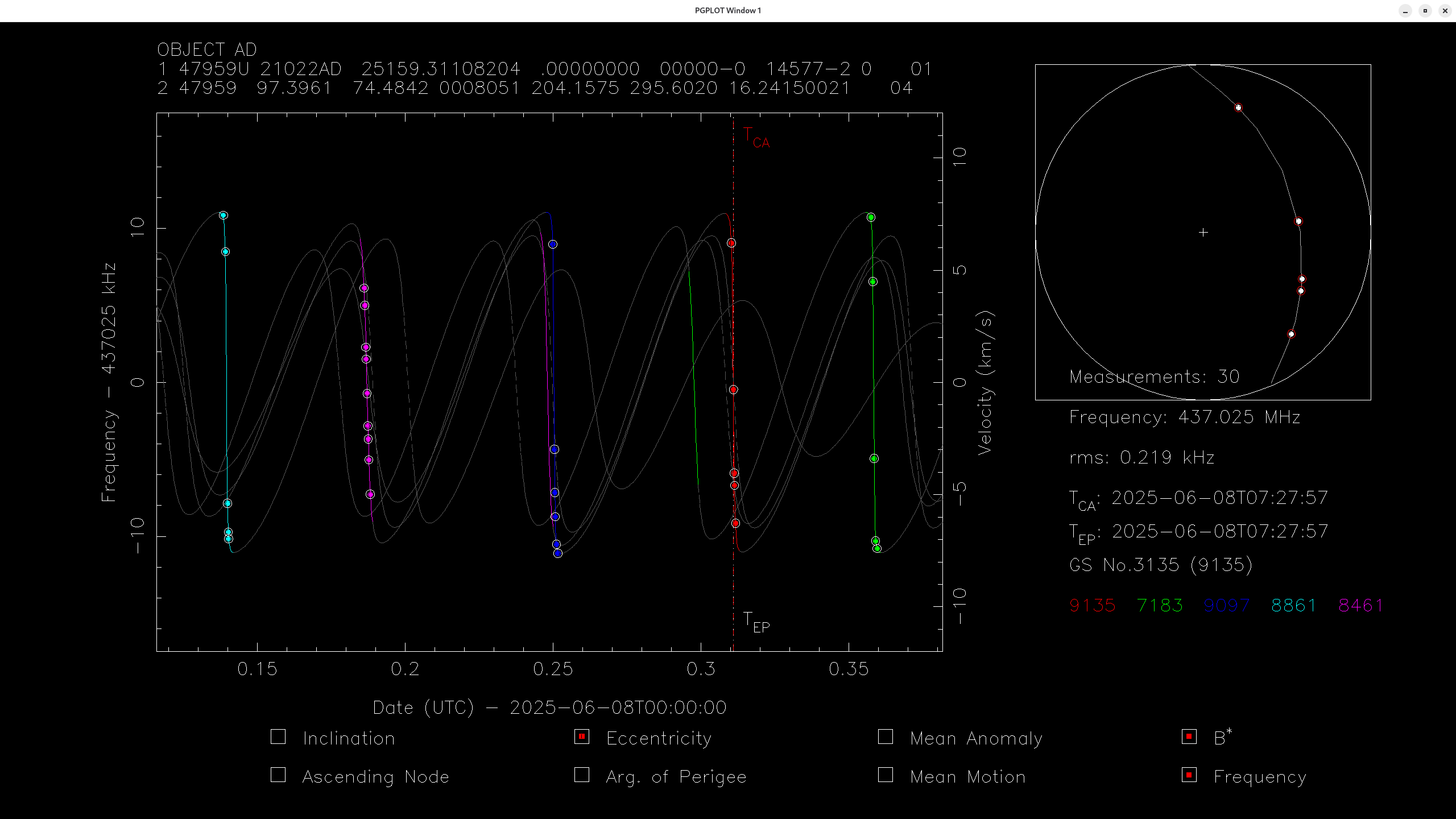

Some hours before its re-entry, here is an updated TLE based on the latest Network observations:
GRBAlpha
1 47959U 21022AD 25158.93882152 .00000000 00000-0 24586-2 0 00
2 47959 97.3969 73.8284 0009164 200.9592 285.6591 16.22202032 04
Both satellites are the same size (1U cubesat) and mass (1.3 kg). Just the solar activity is now a bit lower… maybe…
Btw do you know which satellite was that where there were telemetry data just seconds before the actual reentry, i.e. where it was possible to see how quickly the temperature was just increasing before loss of signal? Afaik there was one, but i don’t remember which one… and if so, can we find those telemetry somewhere?

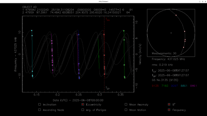

New TLE update:
GRBAlpha
1 47959U 21022AD 25159.31108204 .00000000 00000-0 14577-2 0 01
2 47959 97.3961 74.4842 0008051 204.1575 295.6020 16.24150021 04
grba_159_v4.dat (1.4 KB)
sites.txt (11.0 KB)
How is it matching with the GPS beacons? ![]()

I’m just curious how accurately/precisely can be the reentry be estimated, i.e. after we reach 200km, say, how much time (or orbits) do we have…
No idea, unfortunately I didn’t have the time to create something to compare with gps data or even use them
, I guess we can do an analysis after re-entry and check the accuracy of the generated TLE.
However have in mind that due to the nature of the signal (a flat line without any clear peaks) the produced TLE have an significant error. If CW was active we may had better results.
Yep, the good think about pure GMSK demodulators+decoders (i.e. I/Q => bitstream directly, without skipping the FM demod / audio layer) is that it can directly provide the freq offset, quite precisely… See e.g. mrc100_decode. Alpha is also GMSK but not demodulated/decoded this way…
