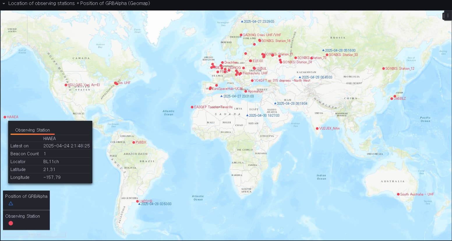

Recently, GRBAlpha is additionally transmitting its position in latitude and longitude like this:
OM9GRB-15 to CQ
GPS:1745833211,6645,22.47430,24.90898,343266.3

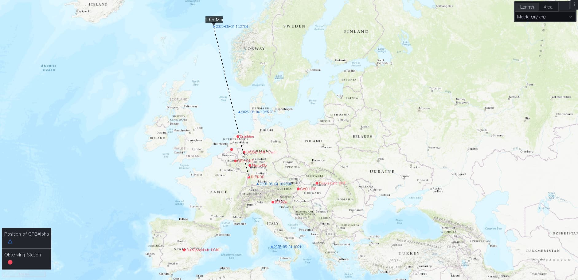

Therefore I’ve updated the decoder to support this new beacon type and completed the dashboard’s Geomap panel now showing both, the location of stations observing beacons from and the position of GRBAlpha.
However, currently there is no update on position information due to noisy high voltage power supplies.
