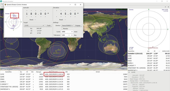

I have a time-mode mismatch in Gpredict, where the time shown in the antenna control differs from the list below (see red squares). The real time is displayed correctly in the list, and the next passage is shown accurately (in 17 minutes).
What I noticed is that the antenna control shows the next passage, but not when the satellite is actually at AOS. When the satellite reaches the horizon, the antenna control switches to the real passage time, where the satellite is technically at the horizon but not yet visible. It seems as if the antenna control gives me the next passage where the satellite has better visibility. Is there any way to fix this?
It looks like a deviation by one orbit.

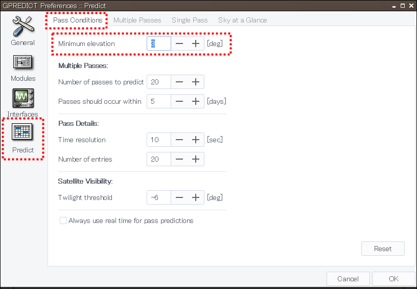

So I guess it’s because the prediction list also shows passes below the minimum elevation threshold setting while the rotator panel only shows passes above it.
