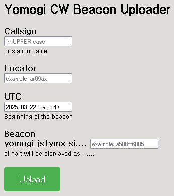

I’ve adjusted my CW beacon uploaders to Yomogi.
You may now use this convenient beacon uploader.
It uploads only the data part and replaces the si part by ...... .

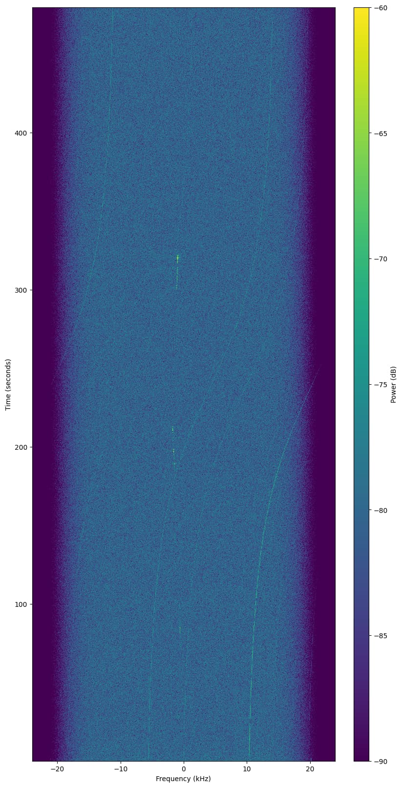

This seems to be before re-entry, it would be sad to stop beacons as it would be nice to have the chance to hunt the satellite until its last orbits as we have done with other missions.
Anyway, I’ve scheduled several observations for the next two days in Network to track it as well as we can
It seems is loosing altitude.
Observation #11284998
