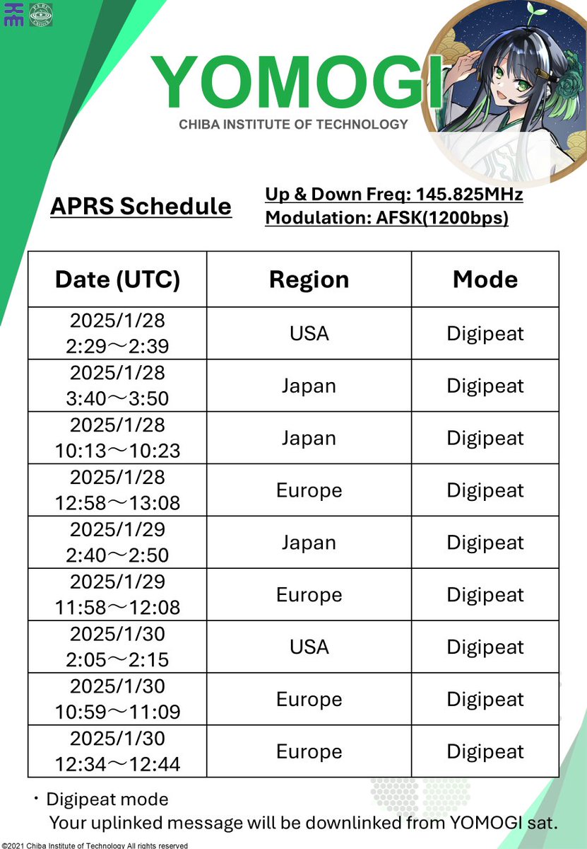

Digipeater schedule for 28th ~ 30th.
Nothing heard and no response on 29th at 11:58 UTC pass to my digipeater packets on VHF.
MEL: 30°
