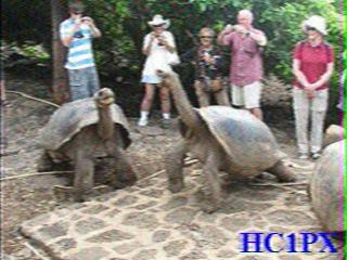

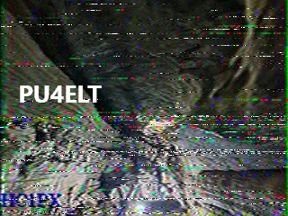

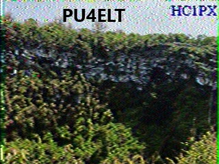

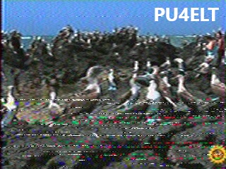

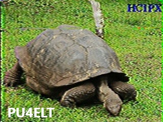

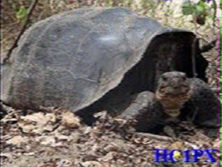

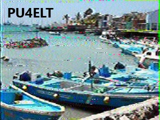

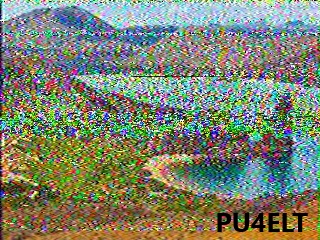

:double_exclamation_mark: Apparently the GALAPAGOS-UTE-SWSU is transmitting images in SSTV.
I will be watching for its next pass over Brazil :grin:
2026-02-20 21:52
2026-02-20 21:55
105x utc nothing heard io83og

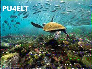

All images with FSKID = 3730. The image number 2 (The turtle) has a sync error, and this seems to be a transmission problem.
