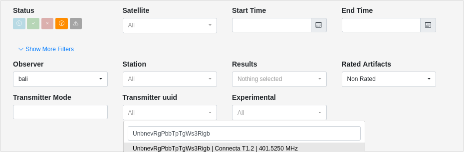

follow this screenshot:
click on
then paste on transmitter uuid
