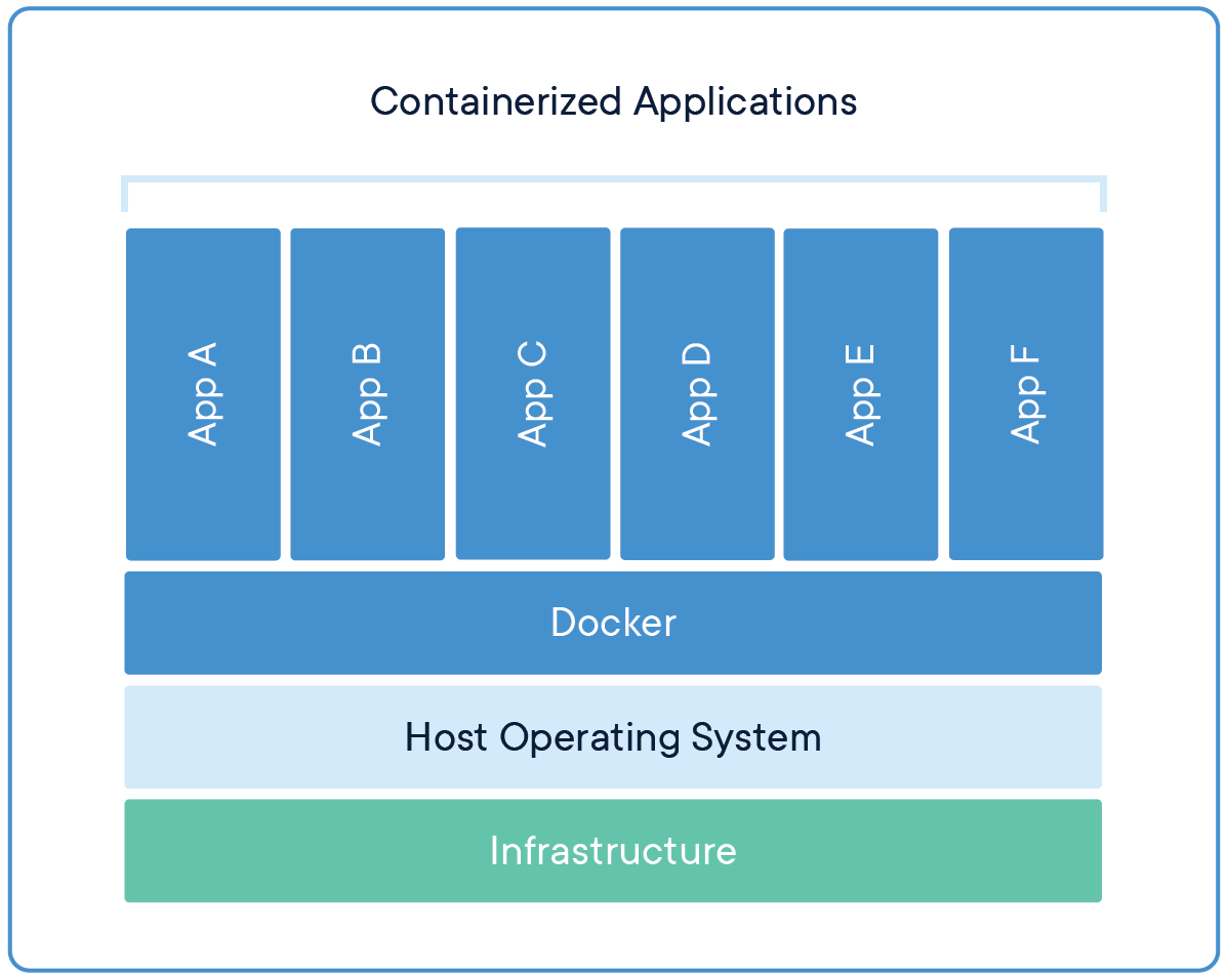

@yo4dft Maybe this image gives you an idea how to look at docker compared to your physical system.
Infrastructure: is the physical system.
Host Operating System: The OS installed on the physical system.
Docker: The software layer that interfaces between the physical system and containers.
Examples:
If you run SoapySDRUTIL --find it will run on the Host Operating system.
If you run docker exec AppA SoapySDRUTIL --find you will run the command inside the container.
Although the commands are the same, it is possible that these aren’t the same version and have other functions and options. So inside the container other software versions can be used.
I hope this gives you an idea on the structure.
