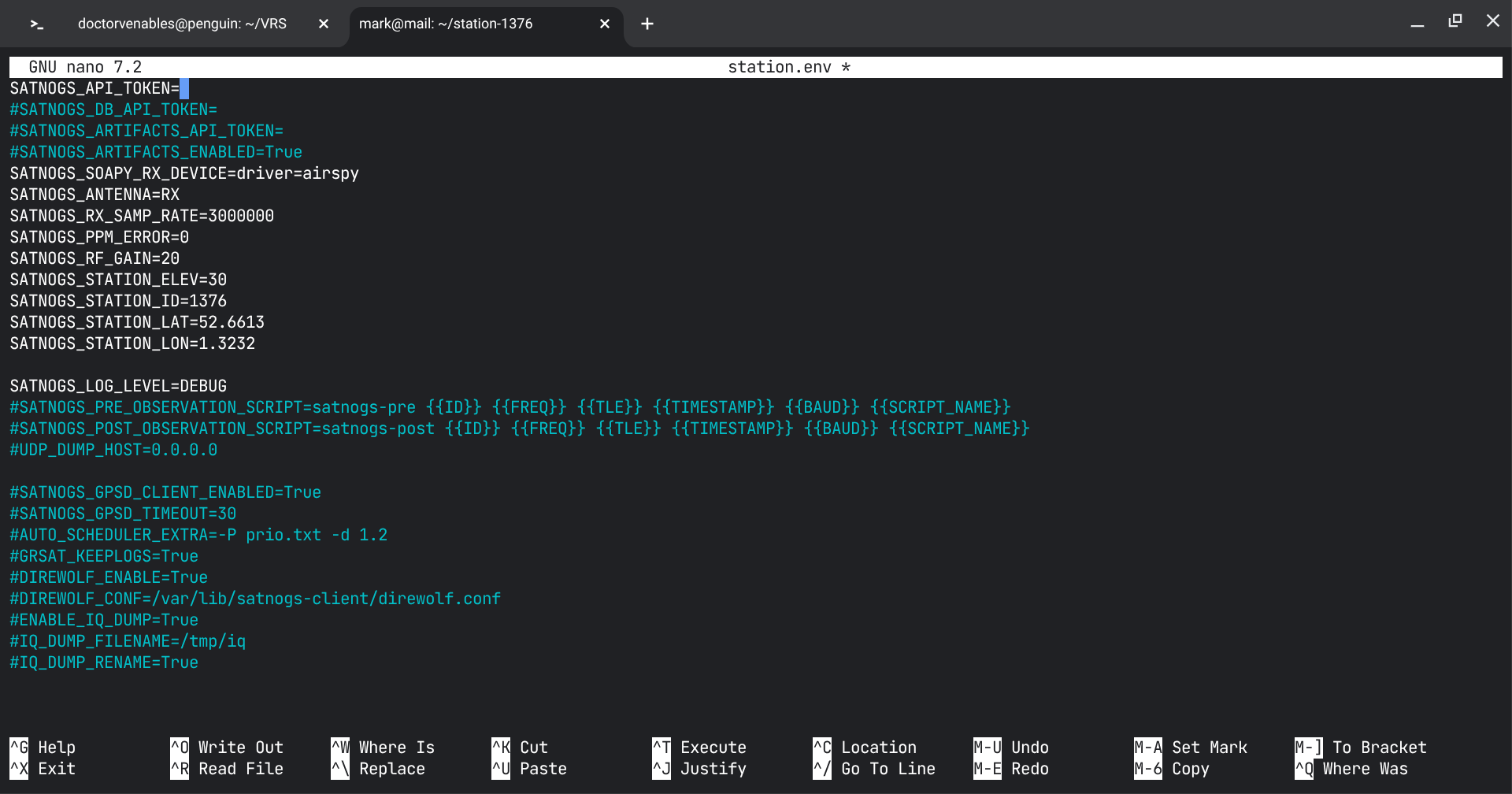

I’ve got the docker container up and running following the instructions BUT I can’t seem to get the Soapy driver to take note of the fact I’ve got 3e6 (or 3000000) in the station.env file. (see screenshot of file with API token removed).
Is there somewhere else I have to change the sample rate?

Hi Mark,
do note that the images has updated and you need to pay attention to the combination of client and hamlib.
The rx samp rate should suffice, but you need to recreate the container for it to apply, a restart doesn’t change the env stuff iirc. do a down/up that is.

FYI the docker down then up (switch if off and back on again) appears to have worked. Many thanks!
