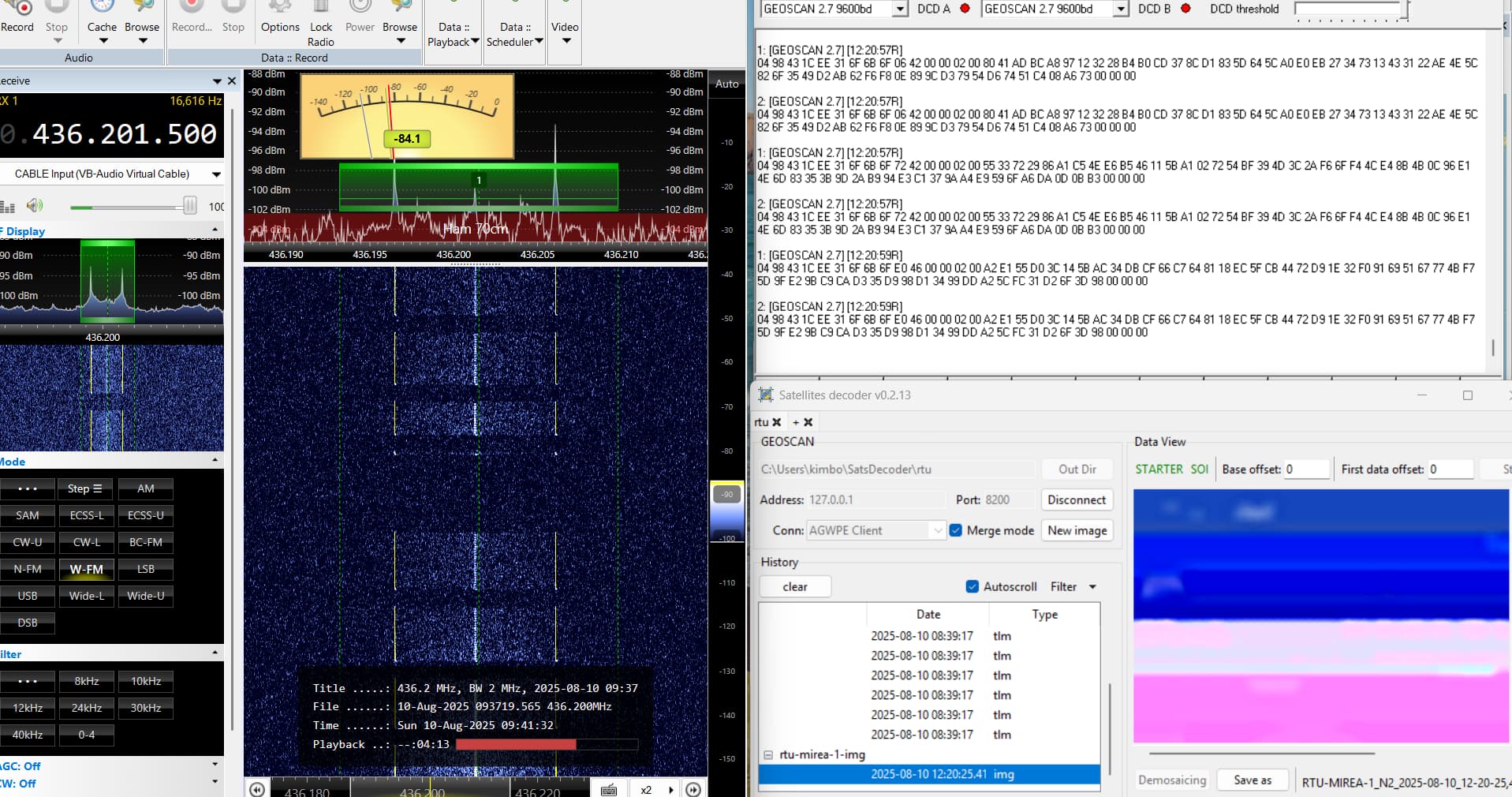

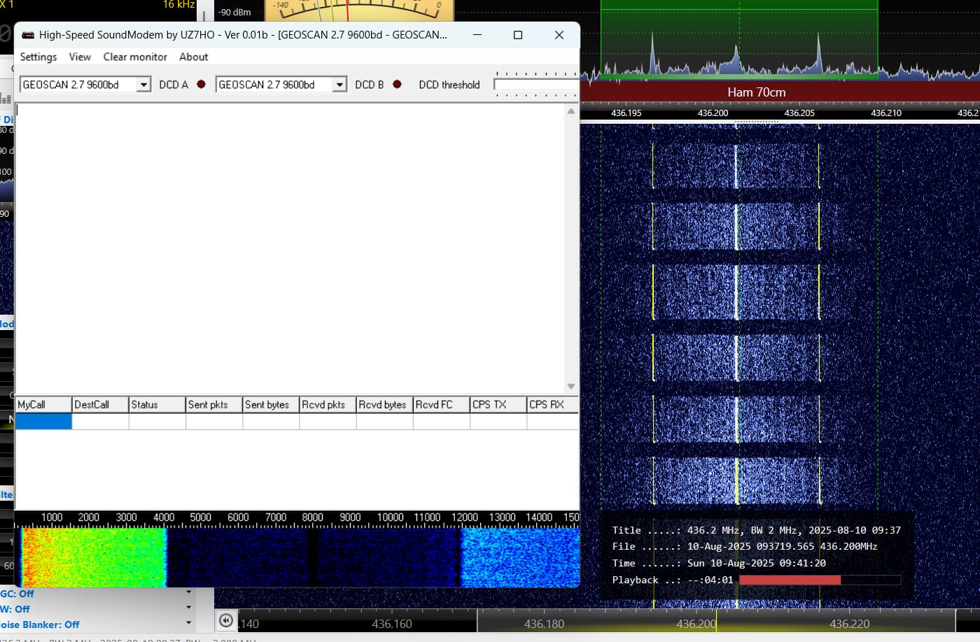

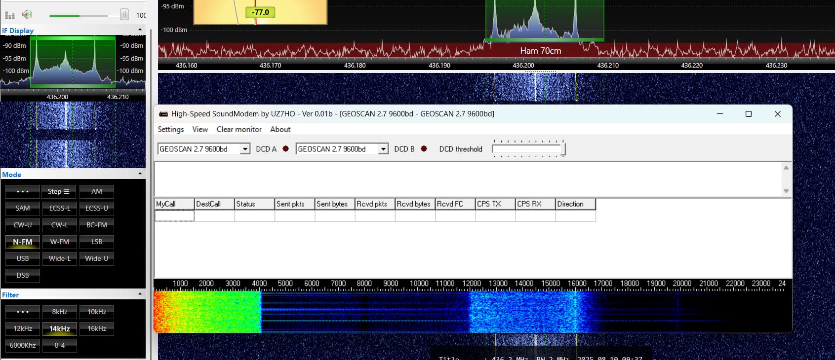

Hi I have tried this but the modem does not work, what am I doing wrong?
EU1SAT
August 10, 2025, 9:55am
8
This gap should not be.
Turn off filters and equalizers.

9
all off
I have tried all baud rates to
EU1SAT
August 10, 2025, 10:31am
10
Check the virtual audio cable settings, input device in sound modem, audio settings and sample rate.

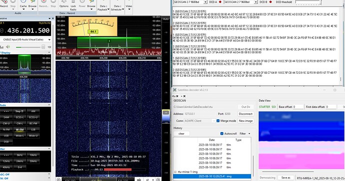

Right I’ve played around with the band width and had to select wide FM and adjust it to 16.6Hz for it to detect the telemetry which works fine and a partial image.
My other issue is poor signal and only being able to read some of the data.
Here’s what I’ve got so far.

Turn off second channel on SoundModem.
Have you got rid of a gap?

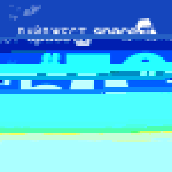

I’ve tried many combinations with it of/off different band width and so on but no full picture I think its down to a poor quality signal being received.
This is all I have been able to decode

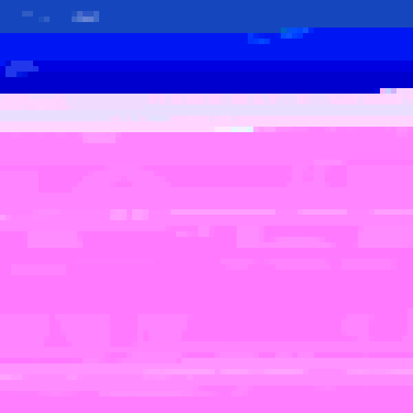

This image(RTU-MIREA-1) was taken in JAPAN.

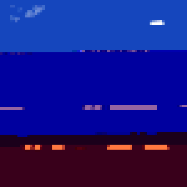

The image with blue background consists of 762 packets.
It only needs a few packets to let the image look pretty distorted.
2025-08-09T20:28 RS51S DL7NDR.mp3.zip (1.4 MB)

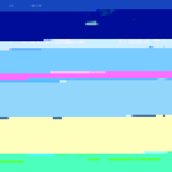

During RS92S4 first pass over Brazil (2026-09-11 ~18:46 UTC), I received only telemetry packets !!
Shortly thereafter (2026-09-11 ~18:56 UTC) the RS92S2 began flying over Brazil :
2026-09-11 19:01UTC
Geoscan-2 (RS92S2) over Brazil !!
