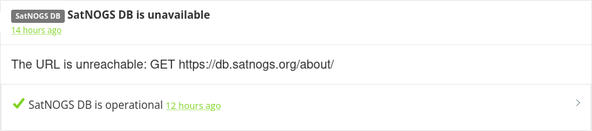

nothing wrong from your side. i think its happen because today the db server is down, around 2 hours.
you can check here
down between 00:27:32 - 02:24:20
btw thank you for your report!
