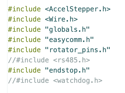

If I understand correctly you don’t have the globals.h library?
The libraries are located here in the libraries folder.
All the libraries should be in the same folder as the Arduino code itself, and these libraries inside this folder should be imported using " " and not < >.
Does this help?
others have copied the .h files to the dir with the .ino

D:\OneDrive\DOSSIER-RADIOAMATEUR\projet-ROTORS-SAT\PROJET-SATNOGS\satnogs-rotator-firmware-master\satnogs-rotator-firmware-master\stepper_motor_controller\stepper_motor_controller.ino:41:10: error: #include expects “FILENAME” or
#include «globals.h»
Did you get it working? Are you using different brackets? you used two different types in your reply.
