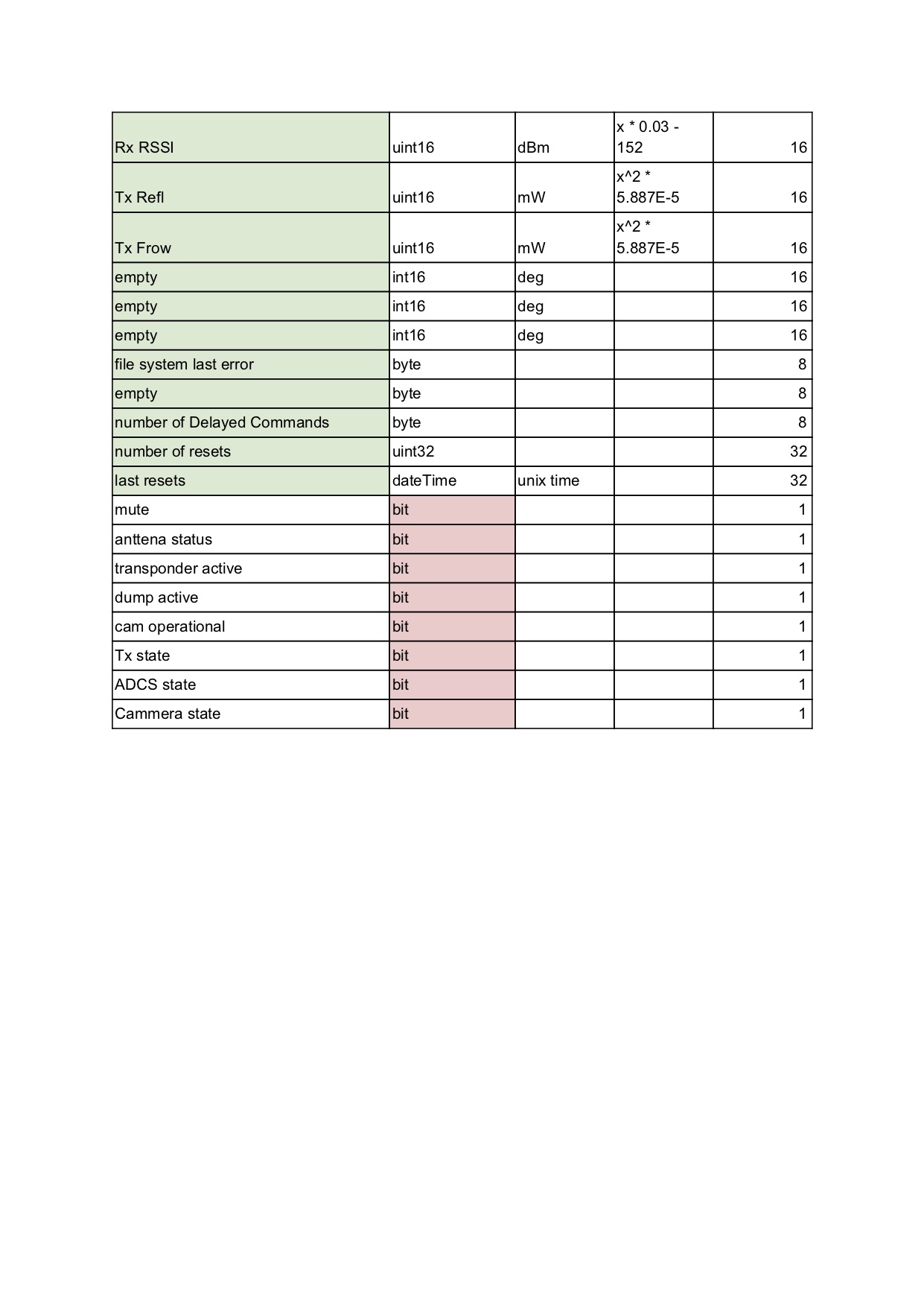

We would really like to work with the SatNOGS dashboards. How can we create a dashboard and what additional format information do we have to provide?
This looks pretty correct from the first glimpses!
I need to add some specials to integrate it into satnogs-decoders (which will take just a few minutes now!) and after merge and deploy into satnogs-db we can start decoding those frames. Once this has started, we could start working on a dashboard at dashboard.satnogs.org. If you like to join that dashboard work: please contact me through direct message and login into the auth0 system while visiting the dashboards main site!
I can see some frames of different type, that are not yet documented in the posts above, they start with a different type identifier 0D instead of 03 - is there a documentation for them available, too?
8E A6 40 40 40 40 E2 68 B0 68 90 A6 98 63 03 F0 0D 5A 00 06 5E 31 3F 0D 00 00 03 EF 00 00
